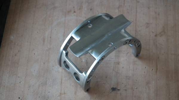

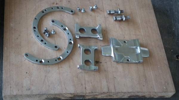

I had a few spare hours today and made some progress with the side rings and spacer bars. I trimmed the rings to length and tidied them up a bit, ready to sand and polish.

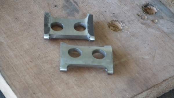

I said earlier the spacer bars need to be at least 5mm thick to take the 5-40 screw holes, but the bars don't need to be that thick for the full length. I have ground a couple of mm off the back with a bench grinder to make them a bit lighter;
I also used a half round file on the ends to remove some material between the screw holes;

Coming along real nice Mike. Looking forward to seeing it all polished up and assembled. Another unique piece for the arsenal!
PS - Jigmaster parts arrived today. Thanks heaps.

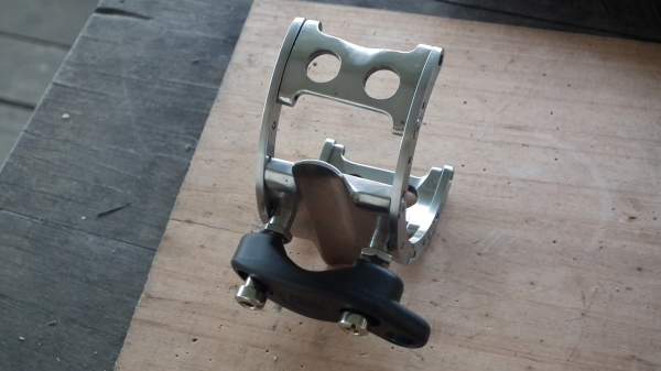

Talking about the rod clamp studs - the Penn 33-113 clamp (as well as some other Penn clamps) use 10-24 UNC thread studs while a few tiburon and accurate clamps I have use 8-32 UNC studs. I decided to go with the polymer 33-113 and 10-24 thread for corrosion resistance compared to an aluminium tib or accurate clamp - and that's what  I had on hand  :).

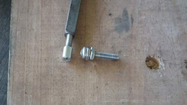

I used the bench grinder and belt sander to make some narrow lock nuts that will fit inside the spacer rings
I also ground the head of the 10-24 screw to about 2mm thickness - as it turned out that wasn't enough to clear the spool. I'll need to think about that a bit more, the holes in the stand are threaded so I could cut the head off completely if it comes to that.

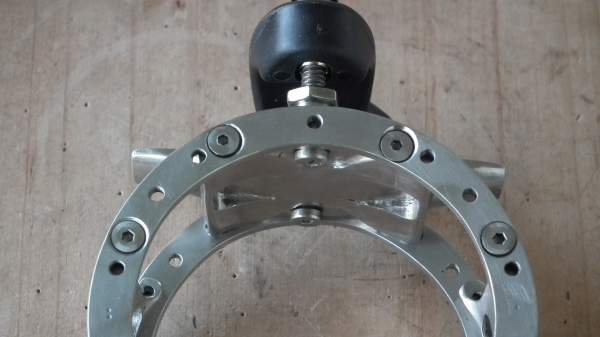

I haven't mentioned I used 6-40 screws to attach the spacer rings to the stand and 5-40 for the rest. The heads of the 6-40 needed to be ground down to fit flush with the spacer rings.

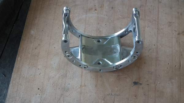

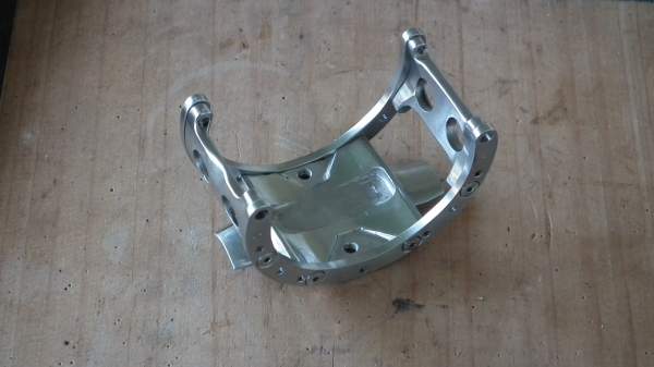

The frame components sanded and semi polished - i'm not sure if I will fully polish it, I don't want to spend too much time on the reel.  ::)
And the assembled frame;
And with the rod holder studs installed - showing the head of the stud sitting too high;
And the narrow lock nuts inside the spacer rings;

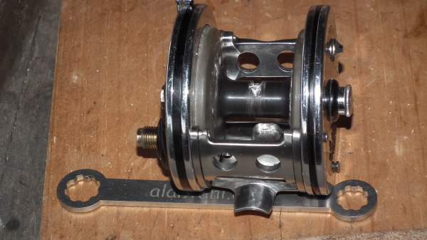

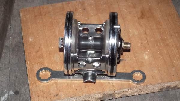

I assembled the reel again to check how things were sitting before I started to make any modifications to the bridge. It still spins freely in certain positions, but a small side to side adjustment of the spool will cause a slight rub of the spool, luckily when it's centred it's OK. I'm thinking it's probably a slight twist in the frame the way it was put together this time, with all custom parts the order of assembly and tightening the screws etc can make a difference to how things sit.
I think that's about it for the frame - the next step is to make a few changes to reel itself.
Looking good, Mike. The talent on this site amazes me. If we all put our heads together we could make and market one helluva reel!
