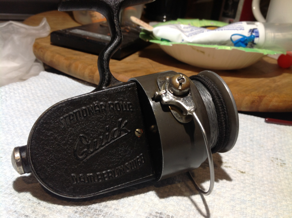

Gotta early '50's era reel I really love, especially after complete disassembly and seeing the engineering, tolarences, material quality. As Fred(foakes) says "overbuilt"! Only one plastic part, the handle knob. These reels seem to have been produced by guys/gals that were proud a what they were doin.
The drag has too much "start-up" hesitation at the med. to higher settings.
So there's a well made drag system, but not alota focus on smooth function. The only other non-metal part is the single fiber lookin/feelin drag washer. Need suggestions/opinions/direct experience info. on this. Replace?, diffrent material?, dry or wet? add somethin else? This site has SPOILED me when it comes to good drag function!

Thanks, Fred. So, I take it I'm missin a felt washer. Would it go just underneath the drag knob, or directly underneath the spool(on topa the fiber washer)or underneath the fiber washer?
