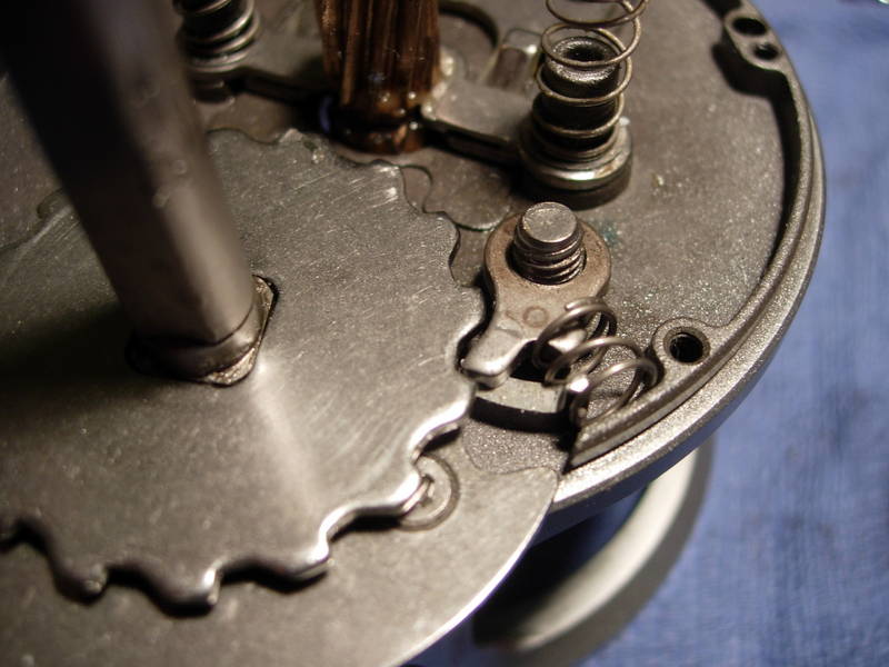

leave the anti-reverse ratchet (key #31) and the anti-reverse pawl (key #32) in place.  if they come off when you remove the main gear, make sure the pawl "grabs" the ratchet and does not just sit underneath it.

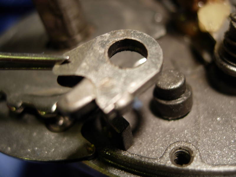

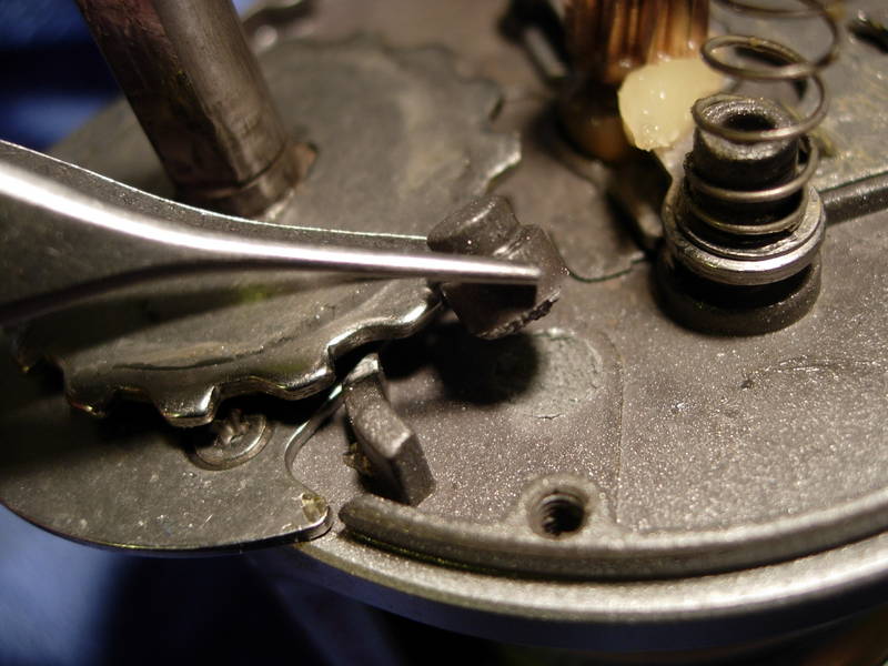

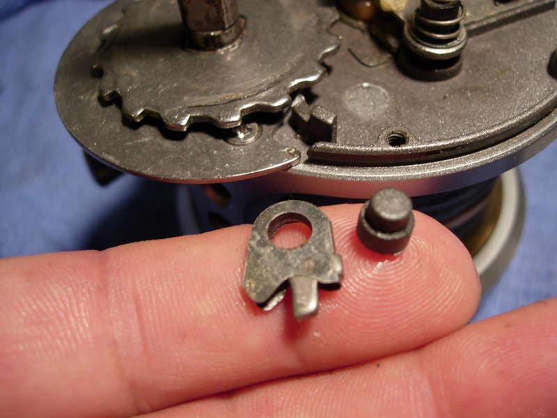

this is a daiwa saltist that was shipped to me because the anti-reverse failed. note that the frame is not machined from a solid block of aircraft grade aluminum. the frame is precision cast. as part of the frame, there is a small stub that sticks out from the right-side base plate to support the anti-reverse dog. well, it's gone.
actually, it's not gone. it sheared clean off leaving the stub and the dog to rattle around inside the reel.
here's what the stub looks like, and here's the proper placement and orientation of the dog.

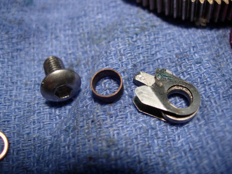

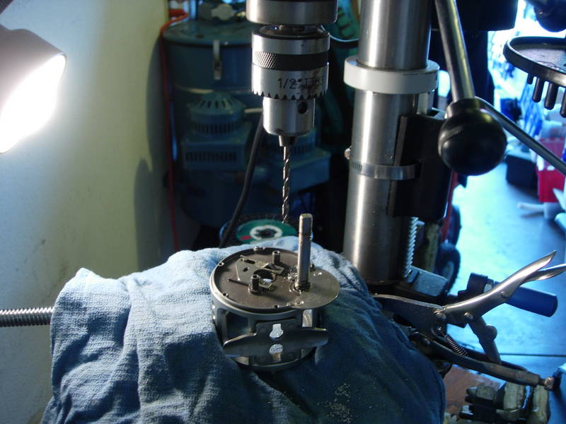

to replace the stub, i drilled out a hole, tapped it and screwed in a 10-32 hex head cap screw from the back side. i thought this was pretty darned clever of me!

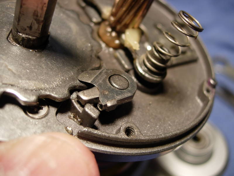

and it almost worked! i ended up damaging the spot weld on the dog and the "spring" came off, so i had to add a sleeve under the dog, then place a round spring in place. under pressure the whole stupid thing came apart at 22#'s of drag.
finally, i replaced the daiwa anti-reverse roller bearing with a shimano trinidad bearing (they're all the same) and the daiwa anti-reverse dog with a shimano trinidad dog (they're close enough) and benched it out to 22#'s without failure. the spool bearings were cleaned out, lubed and re-installed open. the stock drags were replaced with grease carbontex. the stock handle was replaced with full-sized kolekar grip and we're back in business.

ouch!!!!!!! i think you missed getting the ambassaduer-style pawl back on to the ratchet gear properly. if you do that, it grinds like crazy when you crank the handle. sometimes you can bend everything back into place and it will work ok, but i would strongly recommend calling daiwa at 562-802-9589. ask for part #E48-9001. this is the pawl for the saltist 30T. please let us know how this works out. good luck! alan
Quote
It was the anti-reverse pawl that was bent. It was able to be bent back, and it's working fine now. I think I'll still order another one just in case though. Thanks for the help!

QuoteHi Alan, Enjoy your tutorials very much, I do most of my own servicing where I can.
Had a problem with my Saltist 40 by where the reel when under heavy drag the anti reverse pawl would disingage resulting in whacked knuckles. Just finished servicing the reel and could not find any problem with pawl, put the reel back together and tested drag under pressure still the pawl wont engage properly have you any clues as to why, perhaps there is too much grease surrrounding the pawl and this is having an undue affect???.
Much appreciate your thoughts. Cheers, Craig
the springs on the pawl have to be squeezed together more tightly. that still might not be a 100% fix. basically, it needs a spring loaded dog. that's the best way to go and there is no easy way to accomplish it. alan
Quote from: TzerThanks for reply, pulled reel apart again and on closer inspection the pin that the pawl sits on had some dried crap on the base of the pin that was very hard to see. It wasnt much but just enough for the pawl to wedge itself, once scraped off the pawl is now able to move more freely.
glad it's working!  alan

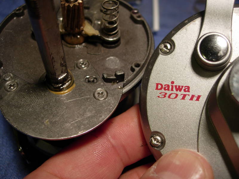

glen, it never held up.  daiwa has to come up with something on their own.
