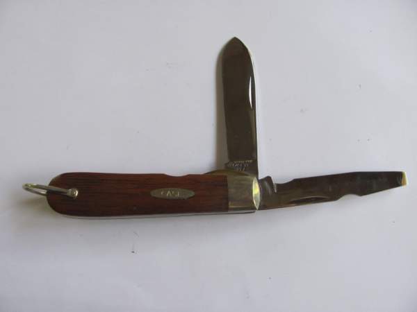

I've got an old Case Electrician's Knife I use for the tough C clips. I just use a mini straight screw driver with a little bend in the blade for E clips, and it's magnetized so that come in handy.  :) I just put my thumb over the C clip, slip the point of that hardened knife blade in the crevice and give a twist. Comes off every time & my thumb keeps it from flyin' across the room.
