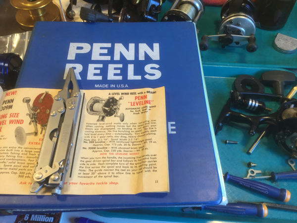

Okay, another auction treasure. Probably should have bought a nicer one, but wanted to see how nice I could make a grungy one!  The operation is flawless now, and a little tip; these cheap chinese cigarrette lighters have the perfect diameter springs under the flint that fit the various cogs inside the leveline 350.
Carl L
And, the before and after pics..
The 350 is an interesting reel, I've worked on 2 or 3.  They are easy to work on and are basic Penn with the "odd" level wind.
