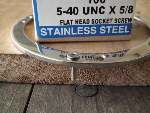

Mike I have some button head 5/8" screws for the 349. If they are any use to you. I can post a set n/c.
They look like this when mounted (or just holding hands ;D)
mhc

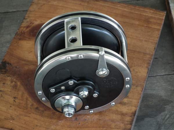

Thanks for the offer Chris, that's very decent of you (considering how the 17 - 18 Ashes Series are going  ;D), but the countersunk screws I ordered have arrived.

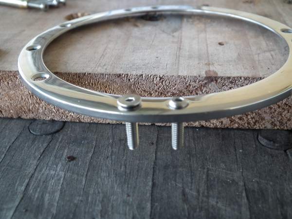

I didn't think of using button head screws although after looking at your photo I probably should have. I modified the countersunk heads to fit and ended up with a similar effect the button head would have given with less effort.
Using a bench grinder and belt sander, I ground the heads to fit in a 5 mm hole then tapered the top side;
Repeat 17 times;
And compared to the stock screw;

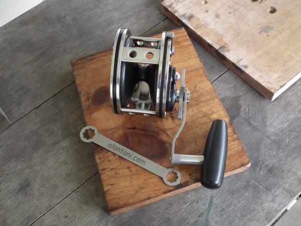

Before I put the reel together, I cut a couple of 2.5 mm thick spacers to fill the gap in the plates where the harness lugs go;
And assembled the reel;
And photobombed by a Cortez Conversions 349 frame  ;D
STRIPER LOU
Looks sweet and smooth Mike. Nice work!
..................Lou
mhc
Thanks Lou, it isn't in the same class as the spectacular green and gold 4/0 you showed us recently.
It takes on a different look wearing Tom's frame with a Newell top bar;
Thanks again for making these frames Tom and thanks again Chris for the SS rings.
