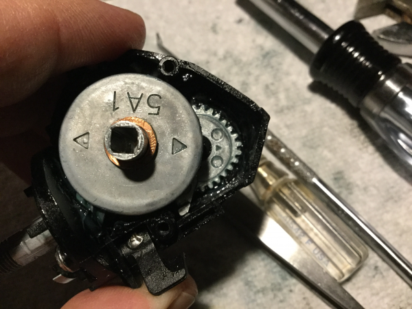

So I have one of these really inexpensive Shimano FX 1000FB spinners. Great value in my opinion..but I never saw one of these torn apart by anyone,,soooooo.....yep took it apart. So it's real simple inside when no IAR is involved,but somehow I always have an issue reassembling. Something I have not seen up to this point is the shape of the oscillation gear.,it's not round. When I buttoned it back up,the handle could barely get the gears turning. Only thing I can guess is the oscillation slider,and the oscillation gear have to be installed at a particular point. There are marks"arrows "on the oscillation gear,but I am not sure if that's what they are for,and if they are,I have no idea where it is supposed to be lined up with.
Am I even close to being right,or am I missing something else?

Well at least my thinking was correct,,but I still can't seem to get it correct,,is this the way it should be? Can you explain exactly how it should be put in?
exp2000
The arrows should line up with the centers of the two cogs.
I find a 15 cm long piece of pink or yellow braid useful as an alignment tool.
The pin on the oscillating gear is also an arrow for this purpose.
First align the oscillating gear with the maingear center.
Then install the maingear whist making sure the arrows on it align with the oscillating gear center.
If the arrows do not align, remove the maingear and try again.
Ultimately you should have four arrows in straight alignment with the centers: Four arrows along the red line.

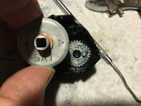

Still not sure I have it right is this the way the arrows should be?  When I turn the pinion gear with  The side cover off it rotates smoothly but once I put the cover on and screws back in it gets messed up again and I tried less and more torque on the screws,still no good.

exp2000
Quote from: Scattergun2570 on January 15, 2018, 04:36:00 AM
Yep, looks good to me.
If it is tight, try removing a shim on the maingear.
But if you have applied force to the handle without the cogs having been first aligned, damage may have occurred to the oscillating gear or drive gear teeth.

Well I think I must have gotten it correct,,it's running smoothly,minus one main gear shim. It feels better than before,no "Geary" feeling anymore. I guess after 15yrs it needed some new grease, but I have to hand it to Shimano,this $20.00 reel lays line terrific...
