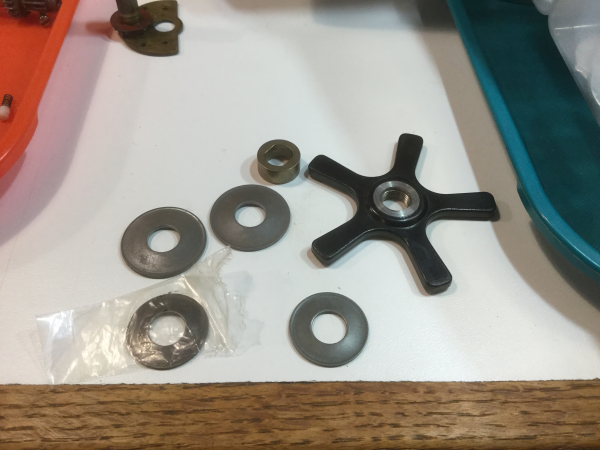

Where can I get the thin stainless washer that goes between the spacer sleeve and the star? I took the handle off this reel to discover someone had hacked one that is supposed to be for the top of the gear sleeve to fit the bigger area below the star. The picture makes the washer look brass, but it is stainless.

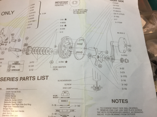

What you need is the 3-18 washer.
http://www.uluajunkies.com/shopnewell.html    Go to the link and scroll down. They call it a lock washer but it is the 3-18 that goes between the star and drag spacer.

Thank you for the offer! The OD is .75" and the ID is .42". It looks like it is the 3-18 washer as Newell Nut suggested - so the interior hole is not round, but rather the shape of the gear sleeve. If you have one that you would be willing to send with the reel, I would appreciate it!

On the schematics, 3-16 or 3-18?  I have both.
