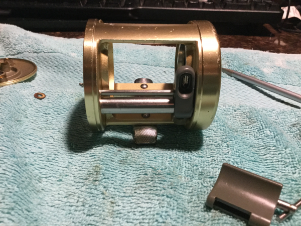

So this Calcutta was not working well...I broke it down.and besides a bunch of sand and old grease,,I can't see anything wrong..I am suspecting maybe the pawl? Because the level wind goes all the to the frame on one side,,and locks up of course,but when it goes to the other side it does what it's supposed to do..comes back in the other direction. Is this a pawl issue?
exp2000
The worm drive is damaged where the pawl locks - replace worm and pawl.

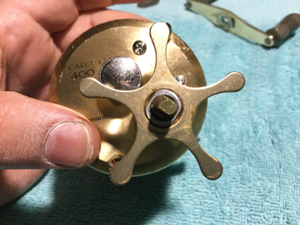

The model should be inscribed on the RH sideplate.
Take a pic and post it.
just says 400 ,no letters
exp2000
Yep,
That's a 400A.
Besides the designation, the two side-plate screws and the hard plastic handle are dead giveaways.
The"A" is understood to distinguish it when the B series followed.
