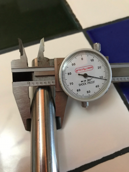

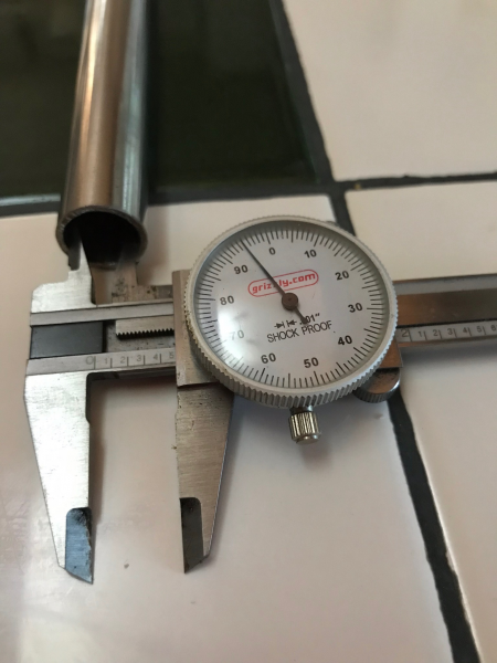

It seems like everyonce in a while you find what you want, or so it seems.  This Stainless steel tubing is just the thing for making stardrag reels (113h in this case) a custom gearsleeve tubing spacers.   Its 1/16  (.062'') wall thickness is good.  inner dia. of .50'' and outer dia of 5/8'' (.650+)     As is sometimes the case the factory ones can be too short.  So with some drag packages the length can now be quite easily made.

$8.78    The Length is 10 inches in this case.  Shipping was from mid USA and quite fast I thought.   Other sizes of course are available.
The tube will be cut for the first spacer length of .375. Or a smidgen more and shortened as needed. 🤦‍♀️
The last hot rod reel I assembled can use a longer than the .350" penn spacer and still back off the stay to zero tension.  Others I've done a brass tube was used, butt this seems better.   🐠
