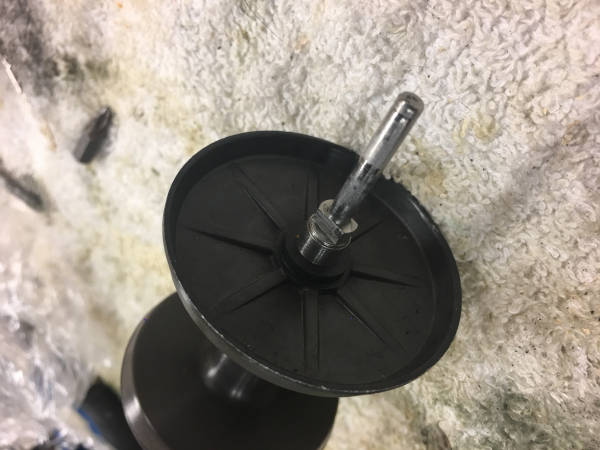

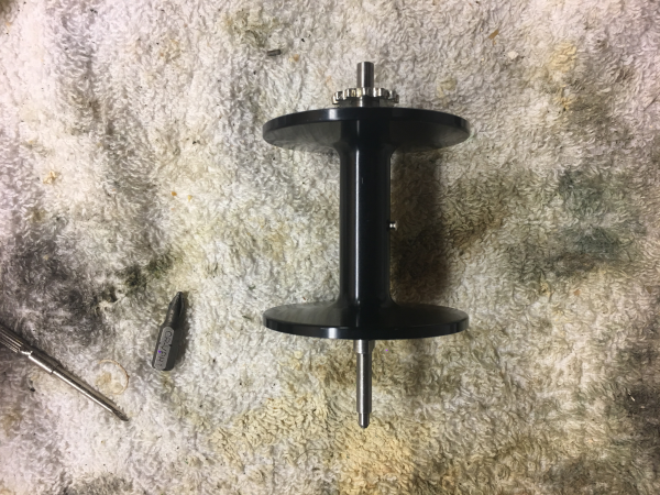

Found a sweet deal on one of these LB 60's!  Clamp stand AND it appears to have an aluminum spool as well  ;D
