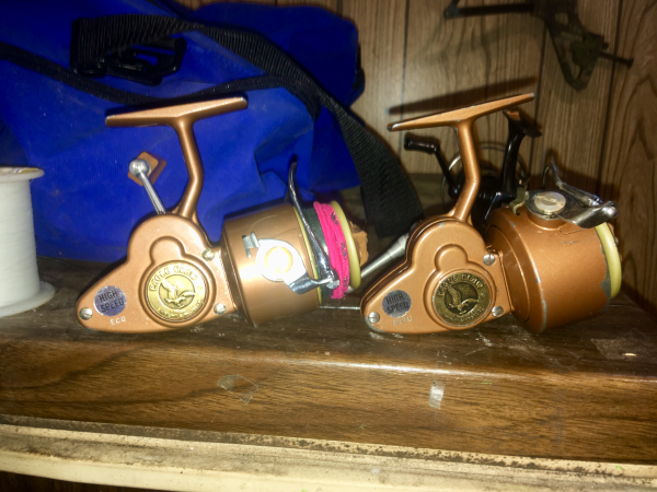

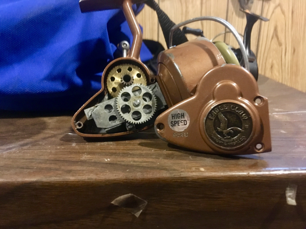

Now on to an Italian, well used in a saltwater environment. Instant antireverse without one way bearings.

I see Ofmer is still in business, likely made in the Oreint now. Much prefer the ECO...
