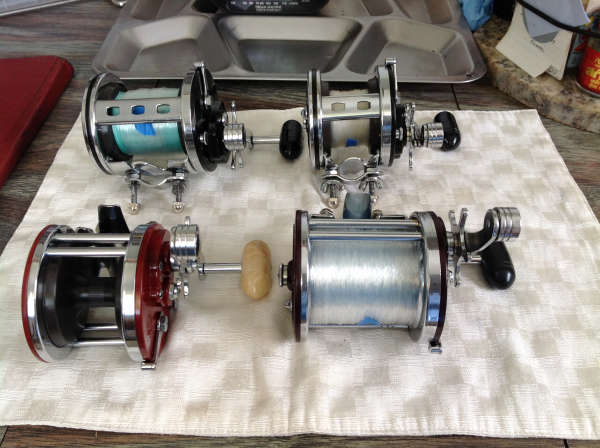

Clockwise from top-left; 505HS, 506HS, 500 and 501
 Nice stash of jigmasters

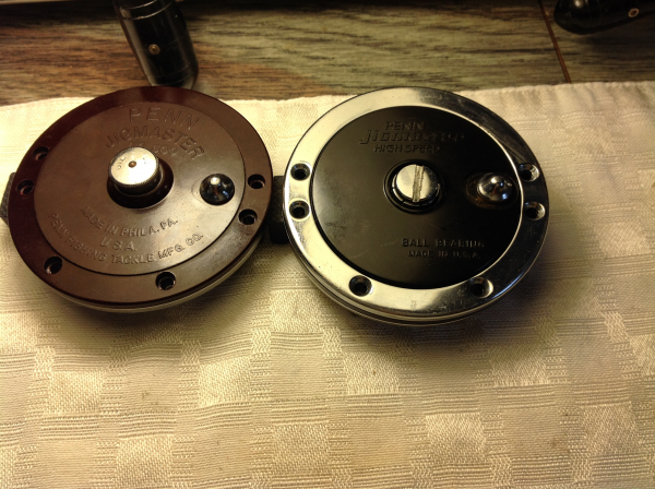

Tail plate diffrences(hope you can see them in the pictures): 500 plate on the left, 506HS on the right.
1) The 506HS; 2-rings, with the outside ring having tapered holes for the screw heads. The 500; only 1 inside ring with the cylindrical head Penn screws.

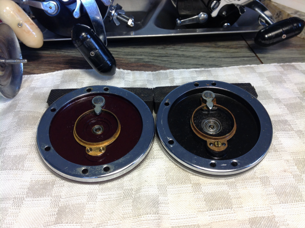

Note: will use just the 506 vs the 500, as I'm too lazy to take apart 4 reels.
2) The inside depth for the 506 plate approximately 5mm, about 2mm for the 500.

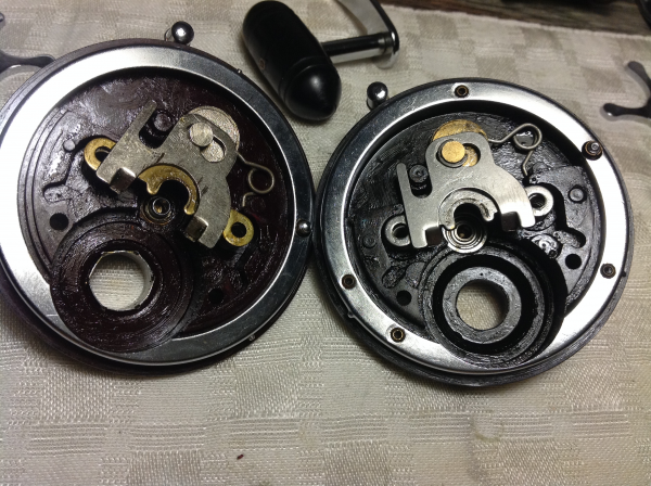

3) The 506 has an easy to replace click spring with a screw, instead of the rivets that the 500 has.
4) Adjustable ball bearing on the HS reels(only tail plate side adjustable)Adjustable bushing(also tail plate only) for the 500.

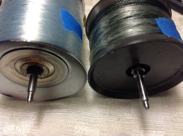

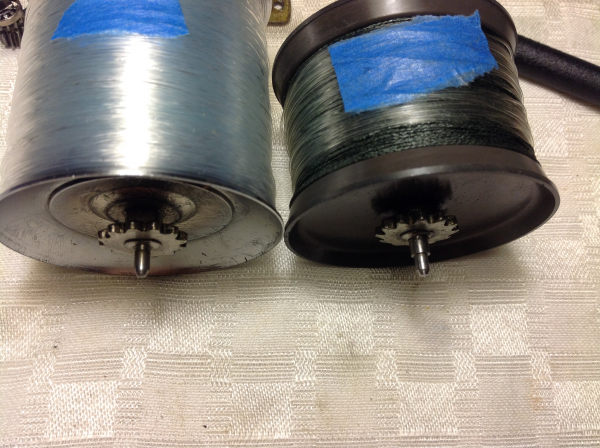

The spool. As far as I know, all the 505/506 came with aluminium spools. The original 500 came with 2-plastic spools and a chromed brass spool(500M)was avalible for extra $(thanks Ted). Aluminium spools started to show up, I believe, in the mid-70's for the 500/501. Please correct anything in error as I'm workin off memory. Thanks.
The spool shaft lengths between the 2-model series are main diffrence: on the tail plate side the 506's shaft is about 2mm longer than that of the 500's, and on the gear side it is about 5mm longer.

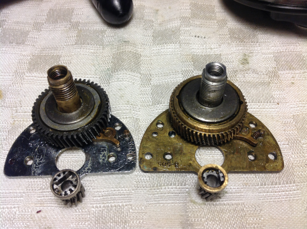

Main gear diameter on the 500: 31.7mm with much coarser teeth, 32.0 mm on the 506 with fine teeth. Pinion for the 506=8.21mm, with a thicker ring on top, but made outta brass. 500's pinion=9.15mm, with a stainless steel lookin ring on top. Both pinions have 12 teeth.
The thickness of the head plate's gear area, on the outside is about 2.9mm more for the 506 than that of the 500's. Inside, the 506's depth is also greater, but difficult to measure.

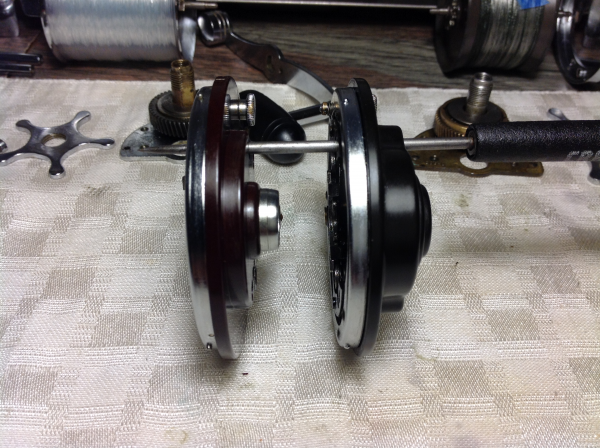

A side by side width comparison.

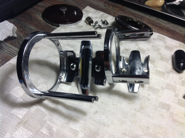

The frames had one stand-out structural diffrence: the 505/506 came with the "2-screw bars" for more strength, as opposed to the individualized posts of the 500/501. Add to that; the double rings on the HS tail plates and the tapered screw heads/holes, and I like that frame much better.

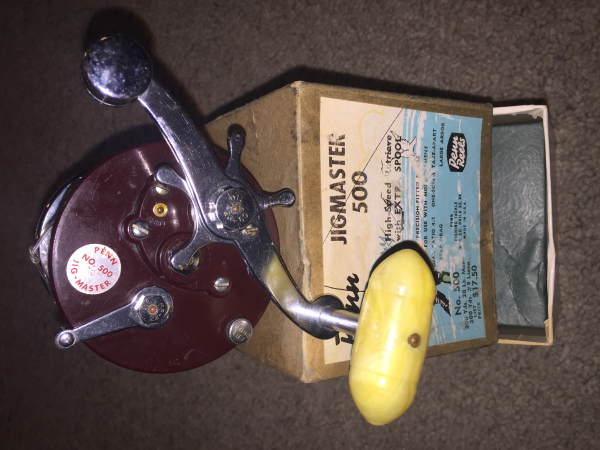

Here's a first year 500 when they used the decal. Been trying to find a first year 500m with the decal but not sure they exist
