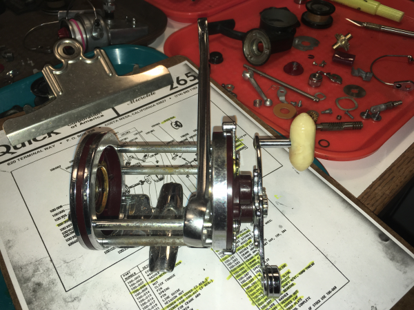

This is an old and neglected reel obviously and the ring(s) are / were stuck solid to the plates. The tail side rings came off with a little persuading, but on the head side I can't get any twist.. Any dried out grease is like superglue based on what I had on the tailplate side. Thoughts or suggestions? It's been in the ultrasonic bath with SG a bit. The take apart screw is free (finally), and I do get the needed bit of pull on it as well, but no rotational motion. I thought I'd ask before trying kerosene or vinegar or both, part of my normal cleaning process anyway.
Thanks-
Rob
I generaly flip the eccentric lever to the left & whack it a few times with the butt end of a plastic handled screwdriver. Make sure you hold outward tension on the on the locking screw. You may have to do the same thing to get it back together if the plates are really swollen.        Rudy
JoseCuervo
Thanks Rudy, I'll try that later if it comes to it! I was thinking a wrench of some kind with pins (maybe snap ring pliers) I can get in the bridge and eccentric holes to get ahold of the plate. Someone may have tried that trick before based on the looks of the lever, they might even have tried banging on the handle, it is bent on both the knob side and the counterweight side.  >:( I guess it is possible some maroon dropped it at least twice.  ::)
Thanks-
Rob

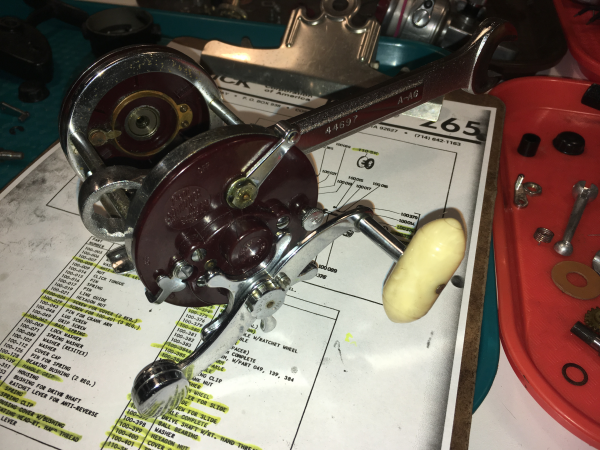

You can use a strap wrench to turn it, it's like an oil filter wrench. Do you have corrosion X? If so try to spray that on the reverse side to loosen some of the crud and try it...................Joe
Squidder plates are so easy to break — and so hard to replace.
If on my bench, I would:
Screw the bridge back in place —
Slide a wrench over the posts as shown —
Attach the tail plate for extra strength and to keep alignment —
Secure the wrench in a vise or a drawer slightly open enough for a "third" hand —
With the crank knob over the Quick take-apart-screw, use your right hand to pull out the screw while holding and rotating the crank back toward you —
Also hold securely in your left hand the tailplate posts and stand —
It should come loose — then you can start the clean up process.
These old maroon, black, or brown 140 plates are easy to break because they are old, thin, and brittle — so I would caution on any tapping on the plates to loosen.
This works...

Thanks for those tips Fred. I got it apart along those lines; I used the AT wrench with a screwdriver through the eccentric hole and my hands were strong enough (but now kind of sore) to break things loose. As suspected it was nasty underneath..
