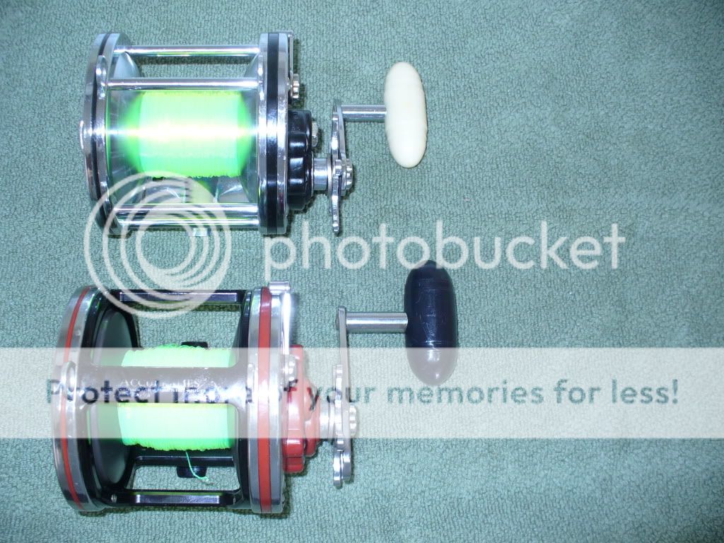

Norcal Pescador
Here's a link to MysticParts and what Penn advertised the 114H for:
https://www.mysticparts.com/PennParts/ReelSpecs/Penn114H.aspx#specs
I like mine and use it for deep-water rock-codding or trolling. 80# Spectra over 80# mono. Not super fast but it works.
I've never seen a stainless spool on a Senator out-of-the-box. Your spool has a 99.99% chance of being nickel-plated brass. If the brass had been polished better the nickel plating wouldn't look so much like stainless steel.
Rob
Dan, I also like mine as Rob does. I have a few, some with the narrow kits, some are the anniversary series with the red spool and some are like the one you have. These are considered light trolling reels, but don't underestimate them, you could push these reels to around 25lb of drag with no problems. I'm going to recommend tha you replace the drags, kit # 6-114 HSP this is a complete kit with carbon washers and metal washers for around $15, you could get the kit from penn parts.com, or check with Dawn at smooth drag.com. A Tiburon frame is also a good investment, and that's about all that the reel would need. If you did want to invest on a Tiburon frame, just google: tiburon fishing reels, they have some new frames that don't require the inner rings when installed, they look sweet, or check with Alan, I think he has some. Invest about $100 with those upgrades and that reel will be your friend for the rest of your life. Good luck with whatever you decide. Sal
