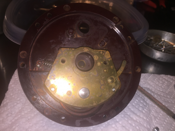

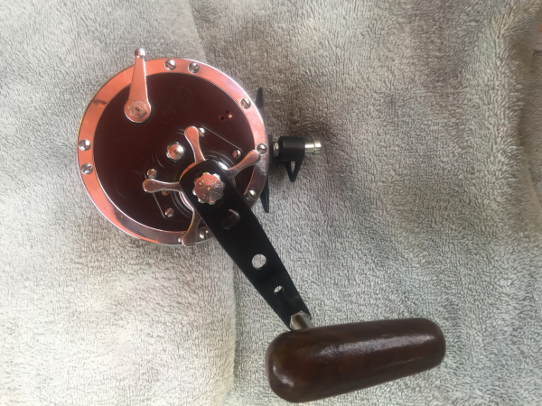

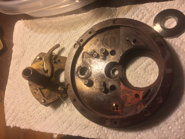

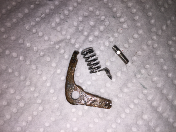

Thought I'd try adding a second dog to a 349h. I had some extra parts laying around from doing the Cortez kit, found a NOS Newell spool for cheap on fleabay (figured it wasn't a narrow 6/0 as listed) a frame from CC and a drag insert from motive fab. I don't have the tools or skills for anything fancy so it's kinda of a hack job. Anyway I had a side plate to trash, a dog from a 49, a yoke spring and the gear sleeve pin from a 9/0.

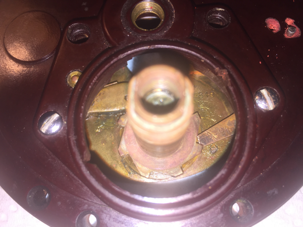

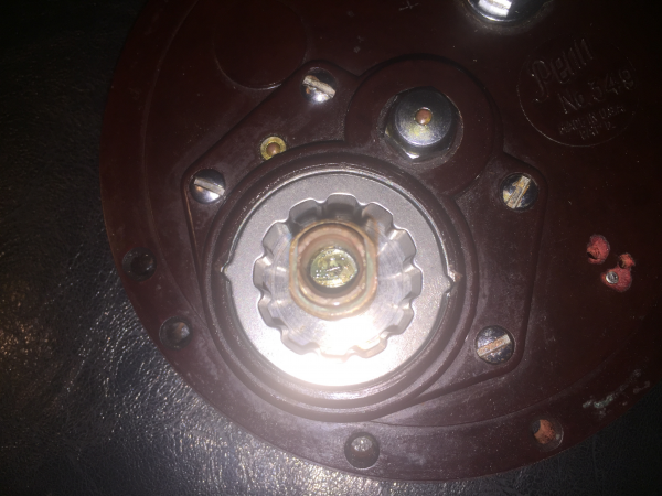

Next I dremeled the sideplates, multiple times to get everything to fit, not much left there but I think enough. I drilled a hole (well 3 holes, 3's a charm right?) for a pin to hold the end of the dog spring. A little filing on the pin for a groove to hold the spring on the pin. Then some filing on the dog to get it to fit. Put it together using the bridge screw to pivot the dog. It actually works!!
Any tips would be greatly appreciated. I have another side plate and 49 dog so I'm going to do it over so I leave more material on the side plate and try to get the dog to sit flush. It's alternating which is what I was shooting for. Pretty much a hack job but got rid of most of the handle slop

And thanks for the beautiful walnut handle knob Sal, fits perfect on this reel!!
Darin Crofton
Cool build, Sheridan, and such a great find on the spool, I really dig the overall look of it!
Very nice job Sheridan, it isn't an easy one, but you've shown it can be done.
I've forgotten about that knob, it is the very first one I made :).
Thanks for showing us how its done.
That's a killer build Sheridan! I fancied the red over maroon side plates in general for a long time, I spose because they are newer, but I now I'm on the side of maroon with black trimmings- maybe reminds of the pair of Broadbill Specials I bought 20 years ago, I dunno.  Something stealthy and ole skool about it.

Looks good but I'd file off the end of the 15-49 to get better engagement, remove the red so the tip fits the gear sleeve ratchet better.  Ideally a longer AR 49 dog filed to fit would work better but they are not available as of now.
Thanks Lee, I was planning to use a fresh dog and file it to get it flush to the dog. Not enough meat left on this one to keep it alternating.
Do you have one?  I might have a stock one somewhere but no telling where.

Looks like a fun project.  A couple things to think about:
1.   The bridge plate needs a flat surface to rest on to ensure that it does not twist under load or transfer all the load to one point on the side plate.    It is hard to tell from the photo, but it looks like the supporting surface was removed for one side of the bridge plate.
2. The dog engagement needs to be tangent to  the ratchet tooth rotation.   Imagine a circle that  goes through the centers of all of the ratchet teeth.  Now make a  line that goes through the center of the dog post that is tangent to the circle.    When a ratchet tooth hits the tangent line, the dog surface should mate completely with the ratchet tooth- nice and flat.  If the engagement gets too far below the tangent line, the dog is basically wedging itself into the "V" between the teeth.  Many custom second dog designs have this issue because it is often more convenient to position the dog post in a non-optimal spot.  Also, it is best to have the dog tooth be as straight as possible, and not too far from the ratchet.
3.  Using the bridge screw for a dog post is a good idea in that the post is supported on both sides,  much better than a just a pin in the bridge plate,  as long as you can resolve items 1,2 from above. Otherwise, you might be better off relocating the dog post.
4.  Here is another double dog 349 build where the builder (MHC) actually tested the load.   If you want to attempt a test yourself, it is worth reading the reply from Sal about tightening down the star.
http://alantani.com/index.php?topic=14241.msg147255#msg147255
-J

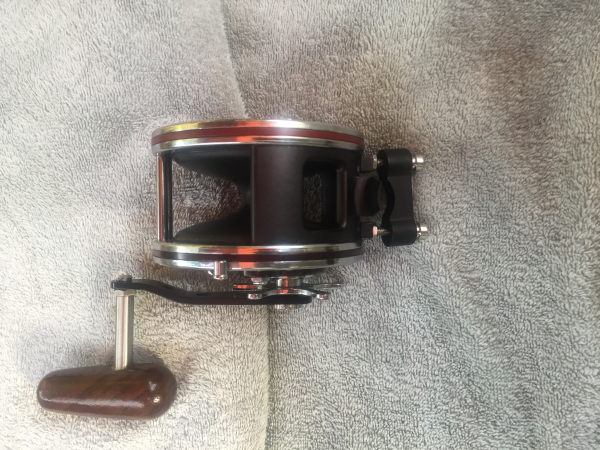

thats pretty nice build Sheridan,
what model of newell comes with that V spool?
