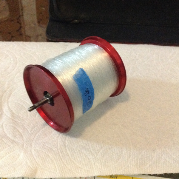

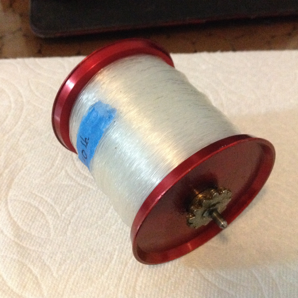

Festus, this's onea them spools I have that's extra. Don't recollect the condition underneath the line, but there's some slight rub marks on the flange edges. Your's for shipping cost($8-12 - ?).
PM sent, brother, I appreciate it!
