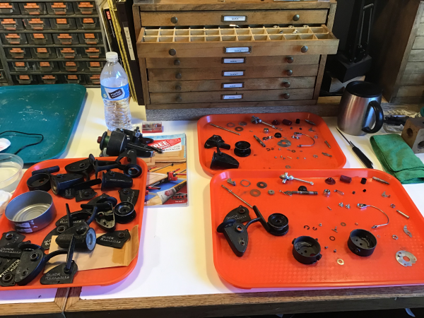

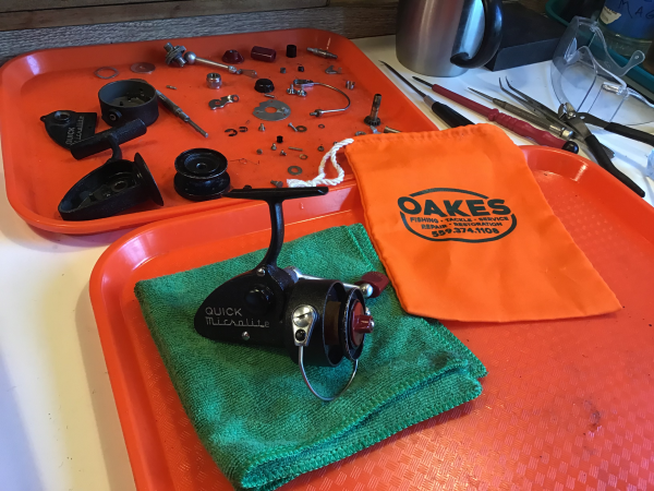

Started building some DAM Quick 265 Microlites today.
Will have 12 completed by the end of the week.
These start out with a complete 265 — fully disassembled, cleaned, repainted, about 50% of the parts are replaced with new old stock from around 1960, modern lubes, fine-tuned and adjusted.
Both cosmetically and functionally perfect for another 50 years.
Then it will be time to start on the rest of the Quick models.
Currently have around 400 complete Quicks to build out of all models.
It is a little faster and more efficient to build two at a time.
These little Microlites weigh 8 ounces — and are engineering perfection.
High quality materials, tight tolerances, large main bearing, bronze gears, steel worm-drive through pinion, metal spool, attractive, and capable.

Commenting from experience I can say that it is much more efficient to do a batch of the same model than it is do one of this & another of that. It becomes almost like an assembly line because after about the third reel you barely have to think.

Hmmmm... I love the Idea of a Microlite over some overpriced ultralight with plastic/graphite parts. But I love to "do it my way", headache, or not. Fred, if I's to NOT do the smart thing and try'n buy onea your resto's, could I get a flea-bay beater, and buy parts from you? How would you be set for DAM Microlite parts after finishing your builds of those critters?
#13
I am limited by spools, frames, rotors, sideplates, and a few other key parts, Greg...
Having said that, you would need to get a reel — then either buy parts from me after all of my builds are completed — or find parts on your own from wherever possible.
These are the rarest of parts, of perhaps all of the Quicks.  So I would also need to keep an inventory of parts for restores for members — and other folks.
If you bought a beater — then got parts from me — you would likely have 50% more invested in total, than a completely restored reel that I do for members.
Some of the seemingly tiny and insignificant parts could cost $5 to $10 each, plus multiple shippings, if even available — and I replace with new approximately 40% to 50% of the total parts in the reel.  These Microlite 265's have 71 parts.
However, you would have the satisfaction of doing it — and I understand and appreciate that.
Glad to help, if possible — but it will be after all of the builds are complete — and I see where I am with inventory for folks who want theirs restored.
I do not do this for a living, just a hobby that likely doesn't even pay for itself — but it keeps me busy doing what I enjoy.
