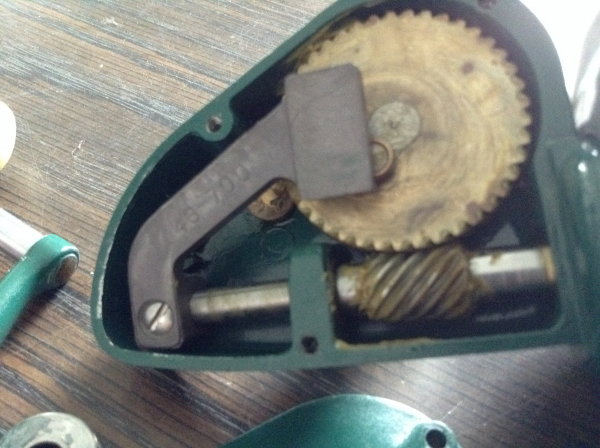

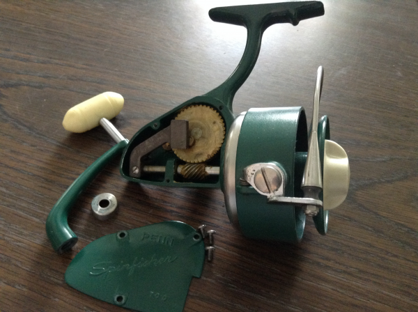

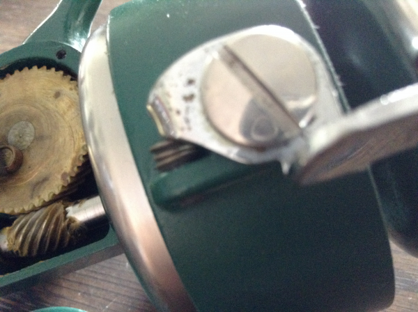

George6308
#14
Took some photographs of my restored Penn 700. It is painted  the wrong shade of Penn green, the 700's were A darker shade from the factory.
Another part not showing is they used a Nice ball bearing. Nice's plant was across the street from Penn. You can see the cast 43-700 part and the spring holding the bail bumper.
