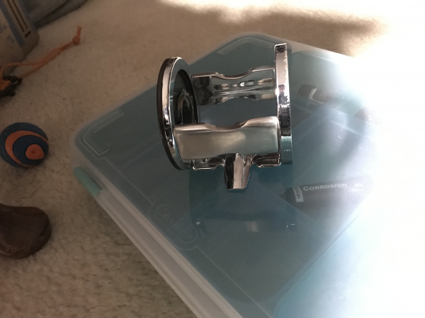

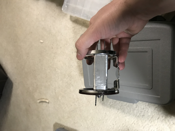

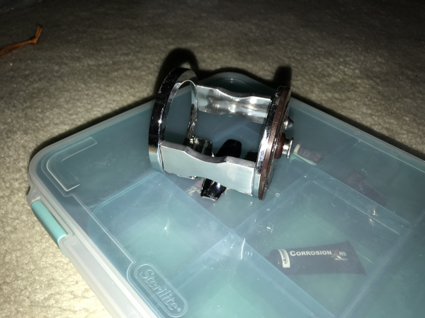

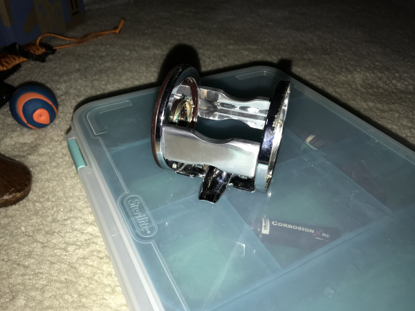

Here's a start. Got the holes drilled but don't have a 5-40 bit yet to tap em
Chuck
Not too bad for just a couple hand tools and a Dremel. Need some finer sandpaper. Next to make some 501 sized.... Trying to bend 6061 for a frame instead of bars didn't work out as well as I'd hoped.

Looking good Chuck! I see you have filed or ground a concave in the back to clear the spool so they should be fine. Thanks for showing us how it went and good luck with the 501 width bars.
PS: Bending a frame would be pretty hard without a lathe or some way to true up the surfaces. Even if you can bend it evenly to the correct diameter the flat bar distorts as it bends and needs to be trimmed back to a flat cross section.

Yeah it's just for a fun little project, I'm probably still going to buy a frame, just seeing what I could do first with what I had at home. The little Dremel sanding wheel came in handy for the concave on the back so the spool has clearance.
