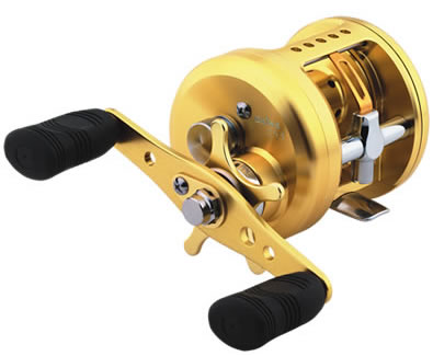

A good friend of mine is throwing BIG swimbaits anywhere from 6-10 ozs with the black sheep 300 (similar to a cvz-300). The idle gear (F91-8801) has shredded twice. When it happens the reel makes a screaming sound, almost like a bearing busted. The bearings are fine, each other gear in the left side plate are all unscathed. It is just the idle gear which is plastic. What can be causing this?
Only thing i could think of was the added torque from large baits is "flexing" the plastic gear and shearing it off at an angle. The extra force required to move the non-disengaging levelwind back and forth is just too much for this gear to handle. Anyways, any help is much appreciated and thanks in advance!

i think it's too much stress on the levelwind assembly.  i'd go with a topless baitcaster.  perhaps one of the smaller 20# reels here.

A disengaging Level Wind is almost a MUST HAVE for throwing those bigger/heavier baits...
Just to much weight for this type level wind reel.
The metal to Nylon L/W gearing is a known weak spot in them...

another quick question though, pertaining to the non-disengaging levelwinds in the 300/400 te's and conquests. Have never seen this problem in any of those reels. Is it just the way the Daiwa levelwind system is designed? I would think they would have beefed up the gearing on each side since they were made for  ripping snakeheads out of cover... ???
