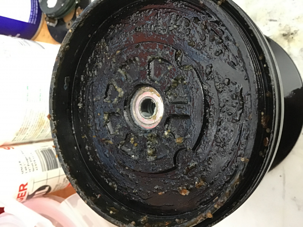

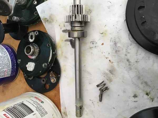

I had a couple of Shakes with stuck key washers,  been racking my brain searching for a solution.   While laying in bed the other night it hit me .. a hub puller!  Went to amazon and ordered a small 3" puller.  I coated it with Plasti Dip to avoid scratching up the reel paint, etc.  I put a nylon washer over the pinion shaft to avoid marring.  Works like a charm!  Hope this helps people with this frustrating problem.
