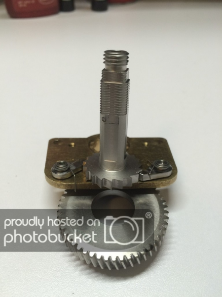

thats for sure will prevent this kind of problems, pics taken from an actual reel on my hands from a friend that use the Baja Special on his charter
but what about the "steel" dog's material, its lots softer than the steel used on the antiverse ratchet, the dogs tends to get chipped until lost contact

I received my new bridge from Mysticparts and can confirm the design change.  The post measures 3.8mm and the peened back measures 4.3mm, a .5mm difference.  Looks like a bigger peen than the design drawing shows.  A big improvement over the original design.  The weak link here now, as Sal has commented, will the dogs hold up.  I put new ones ( dogs) in 2017 and have not used the reel yet.  Will be using this reel in the coming months and will let you know how it holds up. Bill

This additional info regarding the dogs from Tony Dubeck:
Along with updating the bridge we also changed the ratchet from stainless to brass around the same time frame, a softer material for the dog to continually bang up against.
