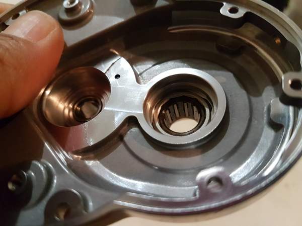

Hey I bought a Shimano TSM II FS, the one made in the 80s.  It has a cast aluminum cage - which i really like.  The "fighting star" however, I ain't so sure of.
I had three questions but since, finally, finding the schematic, I have only one left:
I of course found out about the lone BB / "Strike Ball" - part number TGT0152 on the TSMfs II schematic - after it was long gone on my carpeted floor.  I ordered an assortment of metric BB's off the interweb, does anyone know the size BB the TSMIIfs uses?
I bought this by mistake, I thought it was a TSM III - which i need to complete my 1980s - 1990s star drag plastic and stainless reel mini collection.  What are these reels used for?  I was able to get some limited free spool out of it after cleaning and lubing.
Thanks, Chip

Thanks Thrasher.  I was fooling around with it and took a second look at the schematic.  I reconfigured the cast control spacer, felt washer and what the schematic is calling a drag spring washer within the cost control cap according to schematic and the free spool improved.  I did not see an obvious bend or warp to spool shaft but I will keep that in mind.

Hey Wilmar. I may have a few of those. Let me look tommorow when Im home pretty sure I have a couple or one that will work. I have all  the TSM models II thru IV bought new when I was younger. Did the same thing a few years ago lost to the carpet. If I have I can send to you no charge.  Lance
 :)   The answer to the question "What size BB it is" .090-.092    Harvested from a old bearing .
