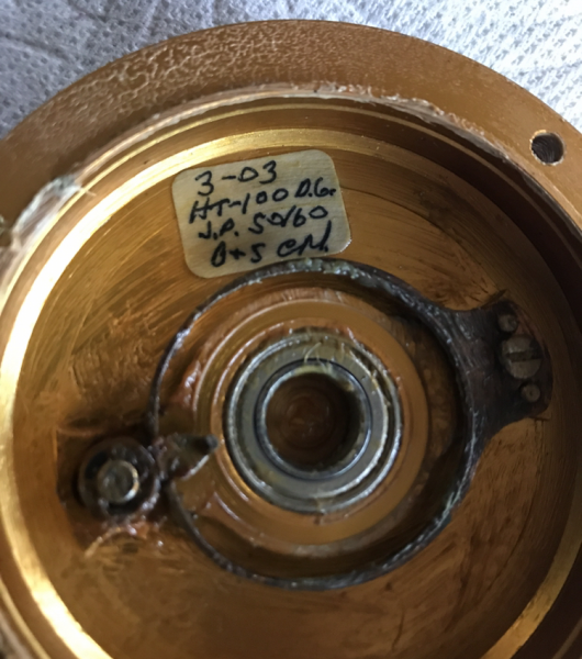

So I also got a 12t that was blue printed and with the tiburon top less frame. Can anyone tell me what the sticker means? All I get from it is 50/60lb and ht100 drags.
As for the metal washers, where did you get them? I just opened mine earlier as the parts arrived. I replaced the drag plate with the new dura drag and for the washers I arranged them to (())). The drag increased a it than when I first tried it, or maybe it's just my imagination. The bearings are a little rough and for sure need replacement. What sizes are these? I also saw the tutorial for the brass sleeve. I might give that. Try.
it might be for 50 to 60 pound topshots, so 15 to 18 pounds at strike.    for bearings, i'm not sure.  calipers to measure them are the way to go, here.
SoCalAngler
That looks like stickers I was talking about from Cal's 2 Speed. I know they kept pretty good records so you if you give them a call I bet they can tell you exactly what was done to that reel. Also you could talk to them about the 16S you have at the same time.
Edit: Looking better at the sticker here is what I get.  HT 100 drag washer, J.P. Not sure what that means but 50/60 line. Bearings and sleeve. Oh yeah it looks like it was dated at the top March of 03. and the last bit looks like Cal's signature.

Quote from: SoCalAngler on June 07, 2019, 04:30:26 PM
I'd bet, Jinkai Premium, from that time frame.

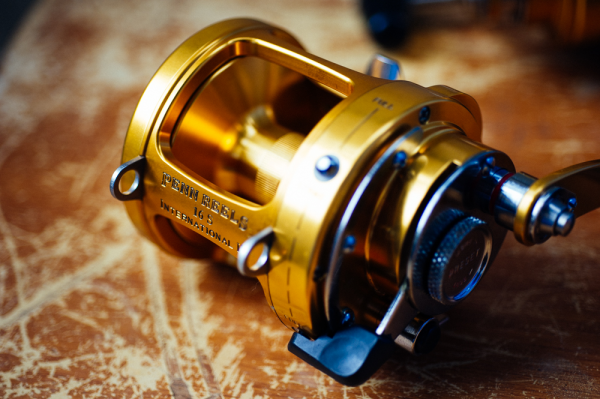

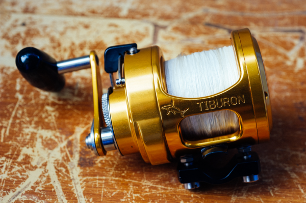

Thank you everyone for all the wealth of information. I followed the provided link and messed around with the washers, and also found some spool bearings (just need the right side plate bearing now). And I am pulling about 18-20lb at strike with the 16s. Here are some pictures of the two.
[Zombie thread alert!]
"J.P." was the John Pandelis (sp?) Special treatment.
Story was, John liked to fish cows with his 12T's so Cal did some special tweaks to make them work.
