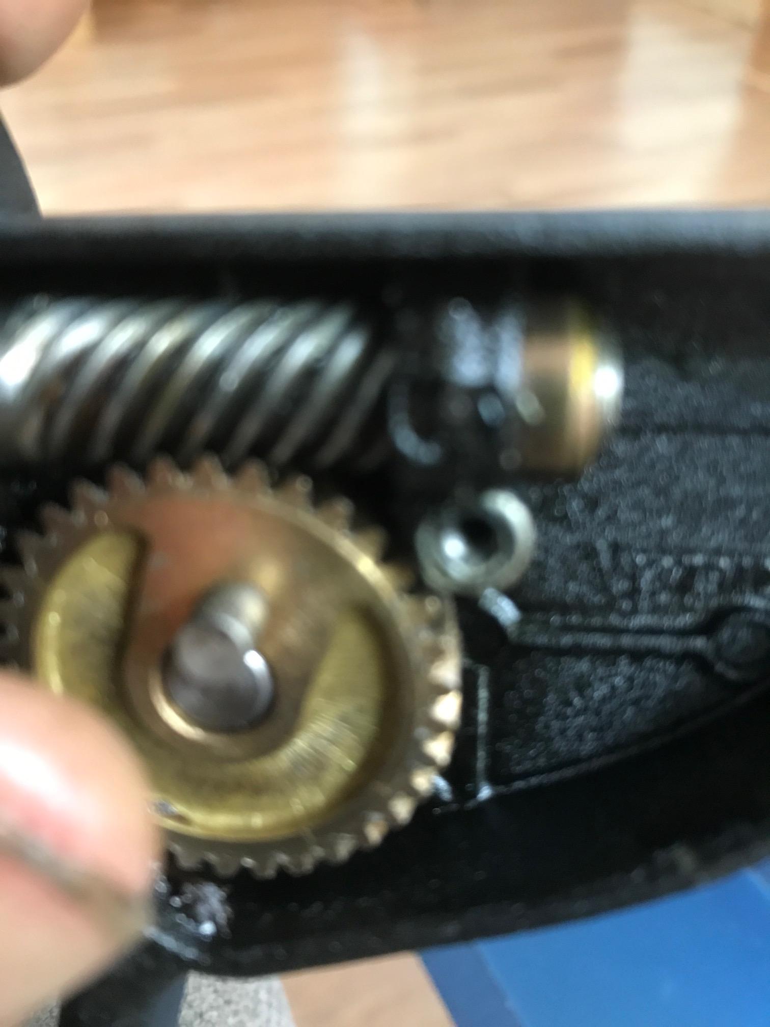

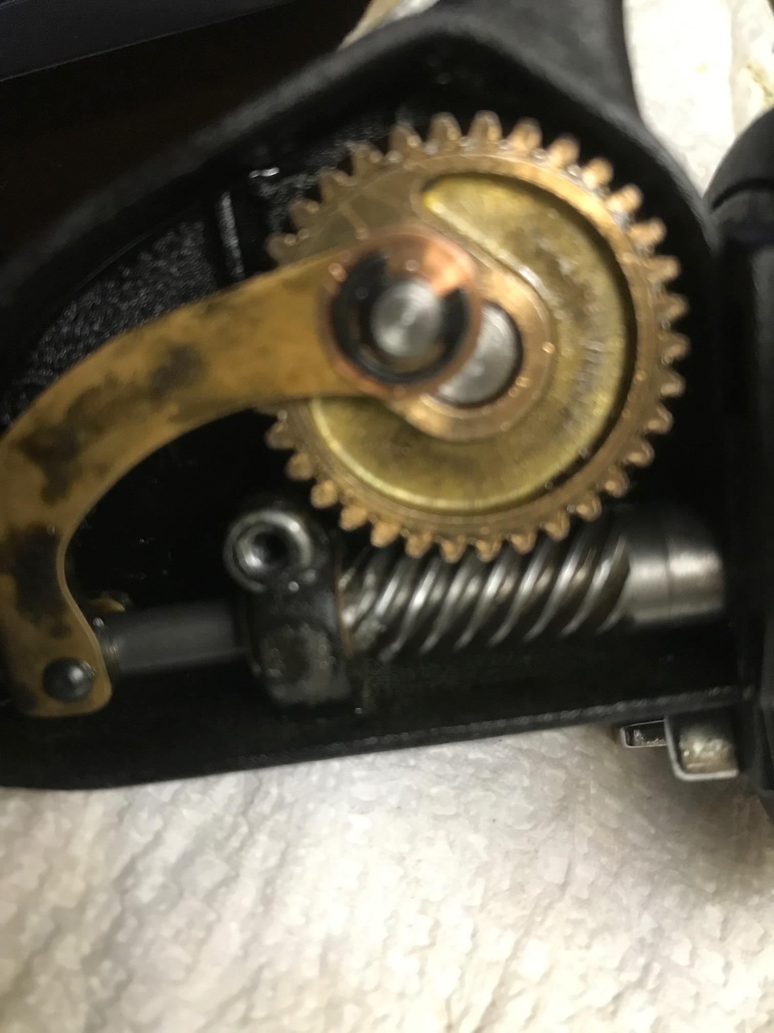

::)  Ok I tried the challenge .. I can build it two ways !!  Large frame is the easiest , the small frame takes a little more work but very doable ...  This is the large frame version .

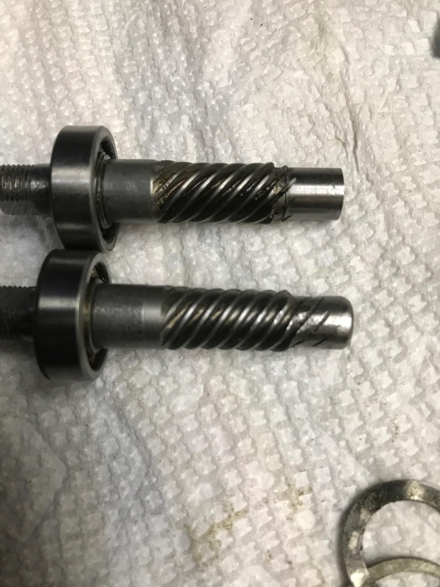

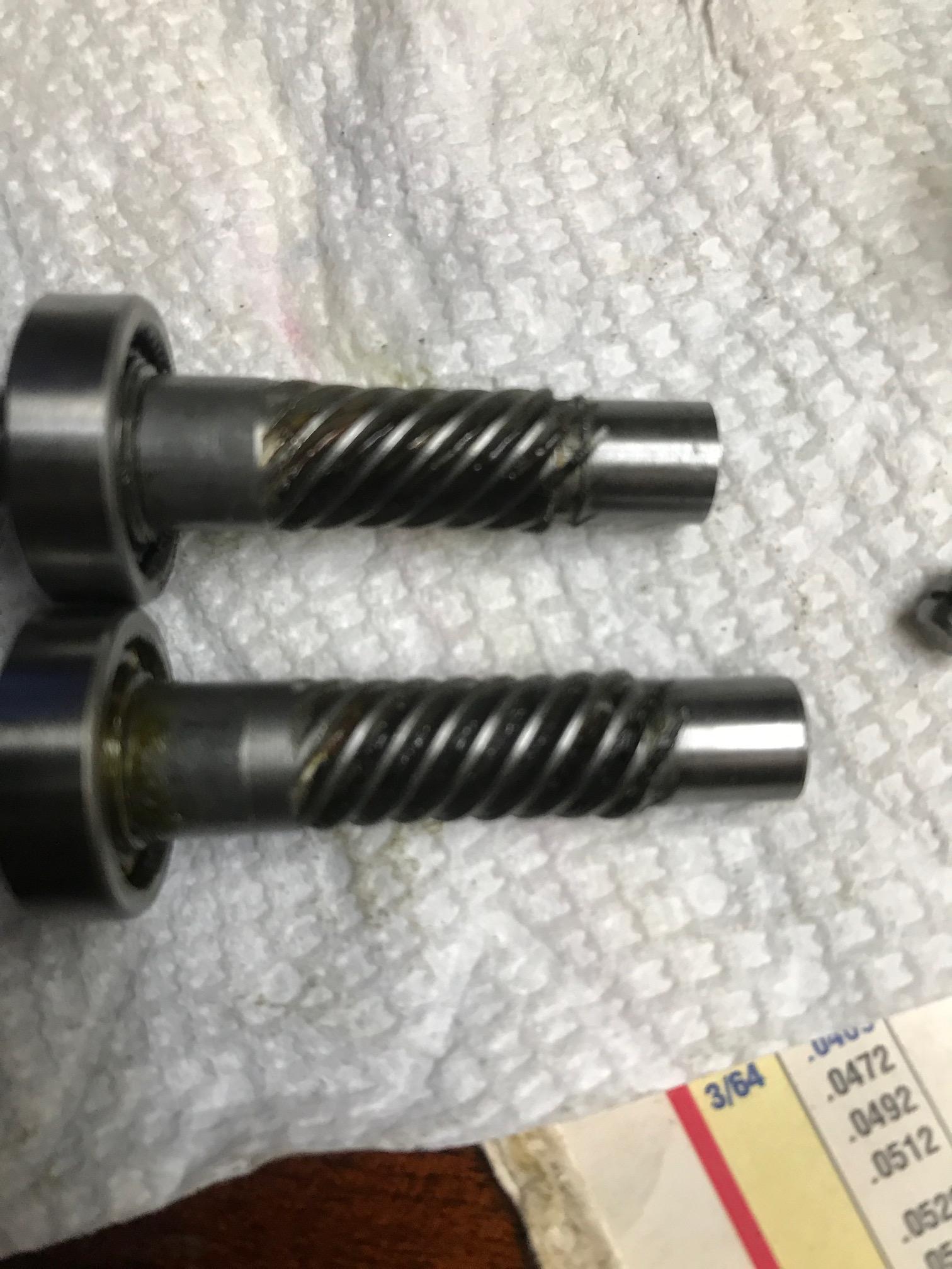

  Small frame 221n      To build this you need to do a little grinding on a 331n  worm , it`s a little to long
  You also have to adjust the stroke if you use the 331 gear by .070 inboard or use a gear from a 221 and change the crank pin  .

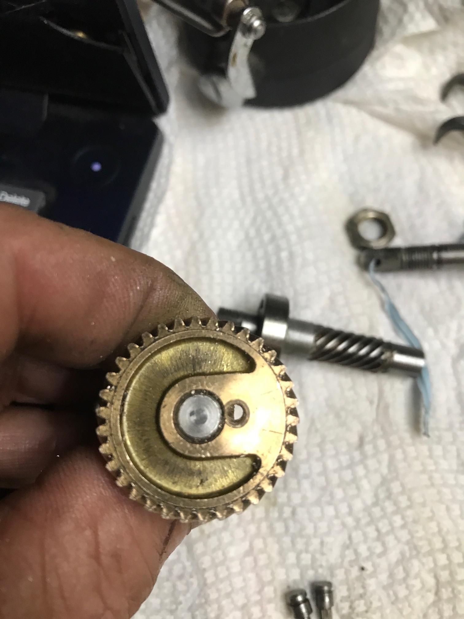

      Here is the finished fit in the crank case .
