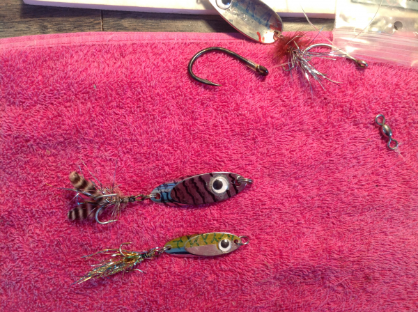

Here's a couple of the Chinese knock-offs I get from Wall Mart. Change the hooks and dress 'em up a bit. Not only a distance caster, but accurate too. Great surf lure.
