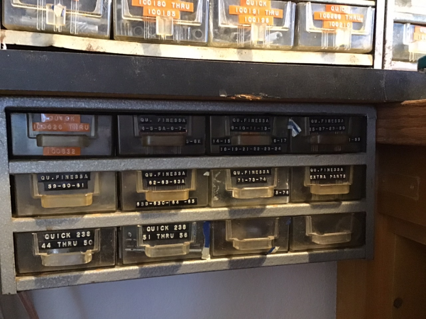

280/285 spools are metal.
330 spools are plastic.
However, they interchange with no issues.
The 330 took the place of the Finessa -- same size -- most parts will work on both -- with a few exceptions.
When the 330 series came out -- it soon included the 110, 220, 221, 331, 440, and 550.
This new series effectively eliminated the 265 Microlite, 238, 240 Junior, 248, Finessa 285, and the 270 Super.
The 110, 221, and 331 are all high speed 1:5 versions -- compared to the standard 1:3 ratios of the others.
When you guys figure out what you need -- glad to help provide parts, if needed.
