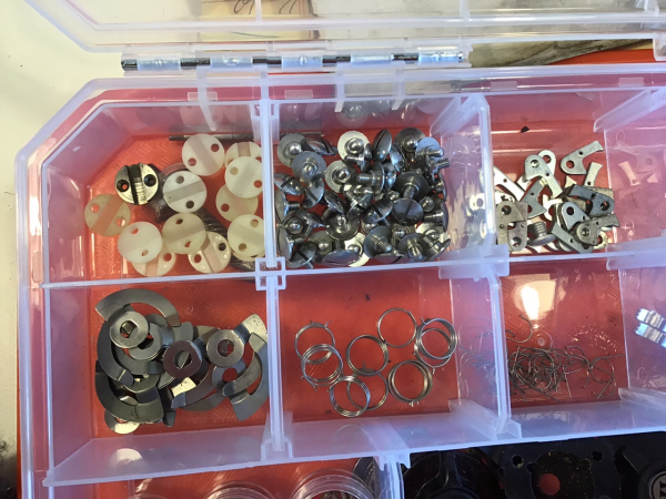

Is the ossilating slide made outta nylon or some other soft material and is it supposed to break under too much pressure?

The round, dadoed oscillating slide is made of a hard nylon type plastic material, Greg --
Probably meant to be smoother -- and also to wear out or break before ruining more expensive parts.
Trouble is, by the time they broke -- Mitchell was no longer producing the replacements.
On another round body Mitchell -- the very tough, and more rare 340 -- the oscillation block is made of steel.
