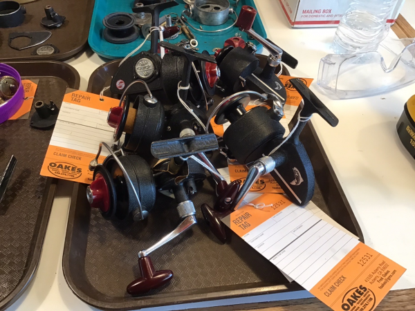

Working on a job restoring 27 old DAM Quicks for one fellow.
Got (5) completed today.
All are as smooth as silk mechanically -- and close to 100% cosmetically.

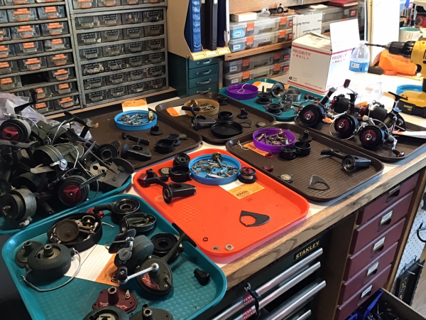

Dave (jurelometer) has been instrumental on giving me expert advice on powder coating from his own experience.  I have purchased and obtained about half of what is needed -- and will complete the rest of the set-up and equipment so that I can start doing all types of reel parts.  It needs to be set up in the outer shop -- and I have hundreds of parts to start the restoration process on.  Safety equipment, basic sense assembly line organization protocols, and a orderly system need to be in place properly before I start.  Good Winter project.
Should be fun to try various colors -- along with sticking to the original colors.

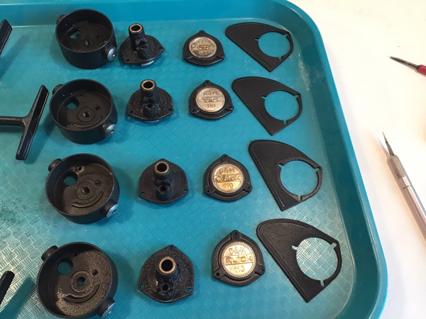

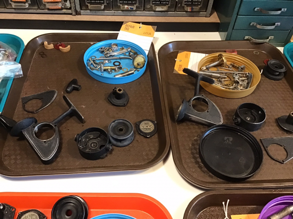

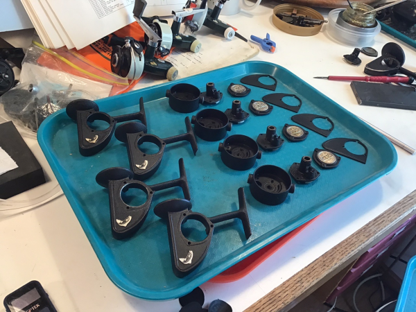

After church today, had time to wrinkle paint (4) DQ 110 Microlites.
Process is complete disassemble, clean and degrease fully, sand down the parts to be painted, reclean, dry completely using the oven, mask off any threads or places where paint may interfere with moving parts, (4) light coats of wrinkle paint (do not let any coat run -- just very light until nearly dry between coats), bake in the curing oven for 60 minutes, remove & wait 12 hours before reassembling the reel.
The detail and the prep are key -- just like painting a car.  Plus a little patience -- and a little experience.
Actually pretty easy though -- just time consuming to do it properly.
But they turn out as factory new.

They look amazing Fred, definitely as good as new! Do you take the fish and badge off or mask over them? If off, what do you use to glue them back on? I seem to see plenty of quicks listed on ebay with broken fish, much like the first gen spinfishers and there badges.
Cheers,
Andrew
The fish get taken off, Andrew --
Then they are re-glued back on with "emblem adhesive".
It is a glue available at auto parts distributors -- to fasten emblems on vehicles.
