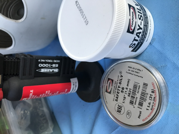

I use a Blazer Torch, some stay silv black, and silver solder. I use my fly vise to hold either the hook or the ring for the jig. The rings are cheaper to get at chain mail stores online.

I guess I meant solder instead of weld.  Will silver solder bond to stainless steel wire?  or do i need brass wire?  The torch pictured might be a butane type?  Do i need Mapp gas?   Just wondering.

The black flux, silver solder and brazing torch are all readily available online.

That little butane torch is all you needed. I used to use a torch meant for searing steaks and such, the flame was too wide. A friend gifted me two of these, and the flame is MUCH more controllable. It only takes a few seconds to heat the ring up for the silver solder to flow. If you want you can have my extra torch, it's unused.
