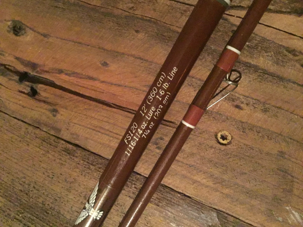

I came into possession of this unused 1978-79 glass Fenwick FS120. It's rated for 1-6lb test line. l've never used such a long limber pole with such light line. Seems like there is a very specific use for this rod, is anyone familiar with this model?
Hi Clint --
It is a specific rod built for Steelhead & Salmon when the experienced angler desires a challenge with light line and small baits.
FS means Fly/Spinning -- 120 denotes a 12 foot rod.
Excellent old school Noodle Rod for finesse fishing.
Quote from: ClintB on December 06, 2019, 05:37:40 AM
Let me know if you want to sell it.
is it actually 12' & marked "FS120 1-6 lb" & nothing else ??? would love to see photos
I would have thought FS120 would be the 15-30# Surf Rod
I have the Noodle from different (later?) era, sold (only?) as 12'+ blanks marked only
"Fenwick Feralite FSH_______" (plus the standard "waxing instructions"  ;D  at the ferule)...
the rod-builder would "cut from the butt", if desired, and fill in the details
I would have sworn the darn thing is 2-8#, but I was assured ALL Fenwick Noodles were 2-6#
pretty sure:
FF = fiberglass fly
FS = fiberglass spinning
FC = fiberglass casting
FSH = fiberglass salmon/steelhead
if it's a truly unused production Fenwick Noodle, keep it as a collectible --
no too many left (especially, not with a factory-printed 1-6 lb. line rating)
otherwise, I can do a love/hate noodle-usage rant if anybody cares

Fenwick offered brown fiberglass blanks for some years after the late '70s for steelhead, with similar specs to this FS120.  The numbering/naming nomenclature changed somewhere along the line, though, with some 12-footers denominated by "144", presumably an inches measurement. "SH" named steelhead blanks.  Actually, now that I think about it further, "FS120" is probably a rod model number, where "SH-1441F" is likely the blank designation for the blank used to build that rod.

Contemporaneous with the FS 120, Fenwick had a FS 106 made from a SH-1262F blank.  The "126" part signifies a 10.5 ft. blank, but the following "2" indicates a "less slow" action than the SH-1441F.  Rated for 1/4 oz. lure as lightest.  I'm not totally familiar with the current Fenwick line, but I'm thinking all the current catalog steelhead rods are graphite.  They still have fiberglass in some fly rods, I think, and maybe elsewhere in the line; maybe a fly blank could be found to fit a demand for a long, slow action rod.  Of course, Fenwick isn't the only game in town.
