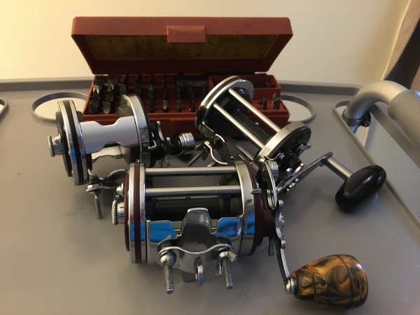

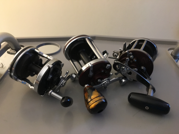

Ring problem solved. Procured another ring (Penn part 2-200) from a different supplier and it fit perfectly. Thanks to Sal for it's handle and the 146's crossbars.

Quote from: George6308 on August 13, 2019, 02:46:25 PM
OH MY LORD WHERE DID YOU GET THAT KNOB ON THAT SQUIDDER?!?!?!? (The black and orangish one)

Quote from: W1R3T4Penn on April 18, 2020, 08:54:28 PM
The knob was made by me for George.
Unfortunately George left us last year due to health issues, he put up a good fight but couldn't overcome the many issues.
George was loaded with knowledge on Penn reels, I invited him to come over our site 4-5 years ago, we were lucky to have him here, he sure is missed.
