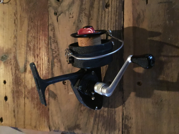

Never really needed a conventional reel with a line counter, but curiosity got the best of me, never really seen a spinner with the l/c.

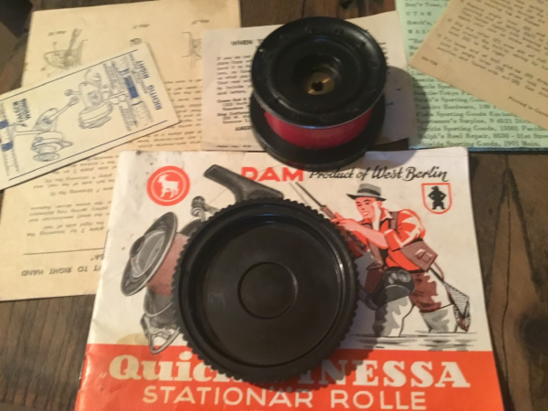

This reel came with the original box and papers along with a plastic bag containing a couple washers and a spare bail spring.  It had been used very little, clean, but not in NIB status.

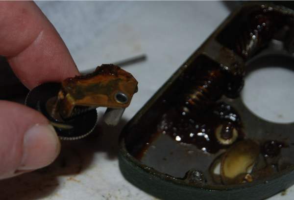

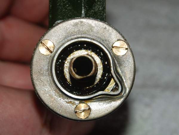

Removing the bearing cover.  Same old dirty brown grease that I've seen in all D-A-M Quicks.

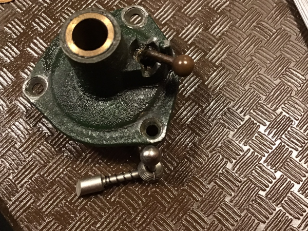

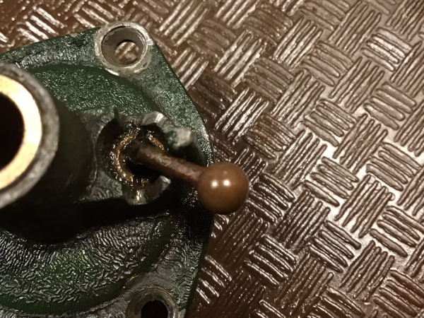

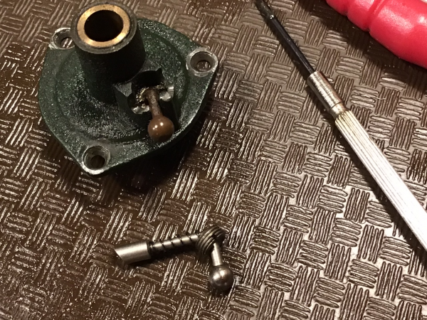

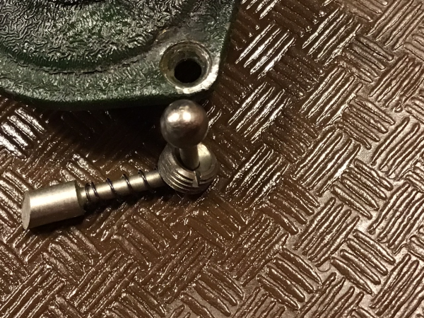

I always disassemble the anti-reverse components for cleaning and fresh lube, but I didn't see any possible way to take it apart.  Usually the ball unscrews, but not so on this one.
If anyone knows something I don't, please tell me.

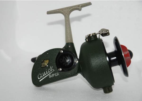

A look at the line counter gauge.  This reel is the export model that first appeared in 1954. This thing is almost as old as me.  ::) According to the specs, monofilament with a diameter of 0.020" is needed for the counter to function properly. (But I'm skeptical).  ???  25 lb. test Berkley Big Game mono would fit the bill.  Normally I would seldom spool anything over 17 lb mono on a spinning reel no matter how big it is.

Well done, Chester! That ball lever is probably corroded a little. It should turn out, though. Maybe a little heat from a hairdryer would expand the metal and loosen it up.
Don't force or heat the ball lever A/R, Chester --
These early models are not like the later ones where the lever is just unscrewed from the A/R pin.
Instead, there is a threaded insert attached to an "L" configured lever, spring, and pin assembly.
This sleeve has the type of slot that requires making a snake-eye tool to remove it from the shift housing.
I either leave them in place -- or get them out if corroded.
A good magnifier and light will reveal what I am describing.
And here are a few pics --
If, after spraying a little Kroil in there -- if necessary (generally is) -- I ruin the A/R sleeve, spring, pin, ball assembly -- I just install a new one.
Fortunately, I have some of these 65 year old parts assemblies.  They are new.
If you end up needing one -- just let me know and I will send it out at N/C.
Be careful not to ruin the shift housing threads or the shift housing itself -- if ruined -- that part is nearly impossible to locate because it is the rare early version.
Thanks for posting the pics, Fred!  8) That's way better than I could ever explain it! As the old saying goes: "a picture is worth a thousand words".  :)
BTW, when I use a hair dryer I always try to apply heat on the back side where it won't affect or bubble paint, and if you're careful, hair dryers don't get things excessively hot.
festus
Quote from: foakes on December 09, 2019, 06:05:05 AM
Thanks for the pics, Fred, I would have never figured that one out by myself.  And I'm glad that DAM got away from that design.
