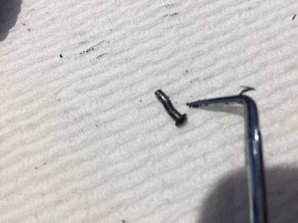

Beachmaster
Well a freakin screwed up!  I couldn't leave well enough alone. The anti-reverse wasn't working because the dog was wore out, so I figured I would wedge a screwdriver in there and bend it outwards a little so that it would catch the notches on the cup.  It worked and I needed to bend it a little more for it to completely catch and SNAP! As you can see it's all over now...I have a reel that cannot be repaired. No anti-reverse. I suppose I could fish it like that...looks like this reel has just been turned in to a parts reel and I will have to purchase a replacement from Ebay. Thanks for everyone's help nonetheless.
