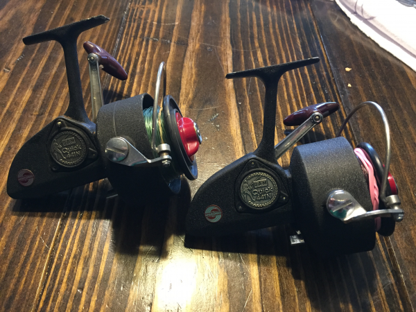

Get a sheet of the carbon fiber like what has already been said I've got a sheet from this listing:
https://www.ebay.com/itm/Carbon-Fiber-Drag-Sheet-Fishing-Reel-Upgrade/111495328332?hash=item19f5a3b24c:m:mXWLmAJ15qaOuABpKv86fvA
I think I got some of the thicker stuff since the resistax washers in these dams are rather thick. I've replaced the drags in my 221, 1001, 1201, 1300, and have a 110 from Fred that he did the drag washer in. A hole punch kit comes in handing I have this it covers most of what I need and comes in handy at times for making my own gaskets for odd ball gaskets on old tractos, and cars I work on as well. Some good sharp quality scissors, an exacto knife, and cutting board come in handy for making your own. If you have a dam quick super a motive fabrication who has listings on here makes a really nice drag stack for the super with titanium and cf disc.
