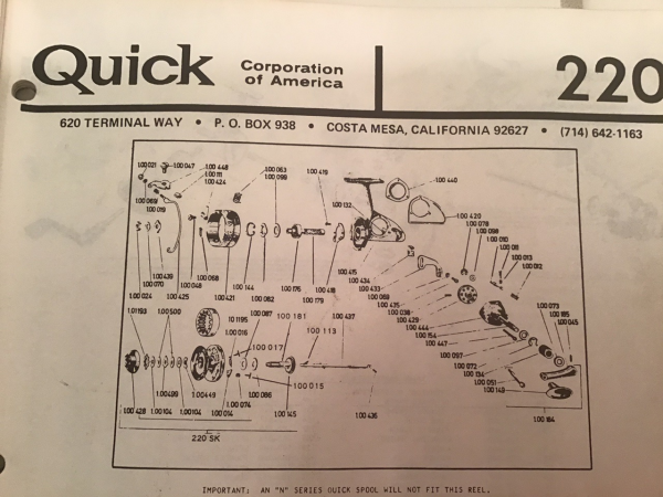

Here is a schematic --
Check out what you are missing -- and let me know.  I should have all the parts you need.
No worries -- don't stress over it -- it is just a used reel that you are restoring.  And I have you covered on parts.
The white nylon washer looks like the one that goes between the thumb nut and the crank handle to collapse the handle -- but I could be wrong.
These are sometimes white nylon -- and sometimes a metal wavy washer.
Add to your list -- and let me know.  I can help when we return.

   I was noticing your spool doesn't use the eared metal washers like my spool...which is the schematic Fred posted. Here's the drag stack from a different schematic enlarged a bit...hope it helps. 8)

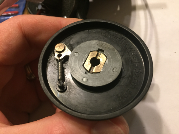

Yes, that is what my drag stack looks like sans the part # 100 058.  I have no idea what that spring is and its not in my spool.  I have:  wavy washer, keyed metal washer, resistex drag washer, resistex drag washer and that's it.
I also think I have come to the conclusion that my ratchet under the bottom of the spool does not work.  When I put all of the drags in and tighten down the drag, there is absolutely NO resistance whatsoever, the spool just turns freely in both directions easily.
    Your spool needs the stack that Fred posted , and you are missing parts .   That is why it is free wheeling .
    That spool does not have the 2 groves for ear washer .
  I do not know if this will help  or get you into trouble .     https://alantani.com/index.php?topic=24932.0

But my spool does not have that "star washer" configuration.  The star washer will not fit in my spool at all.
Quote from: Beachmaster on January 30, 2020, 02:37:37 AM
My spool does not have that "star washer" configuration.  The star washer will not fit in my spool at all.
   You are correct...forget about that "star washer" configuration. I looked hard at that schematic I posted...and to the best of my eyesight that is a coil spring you're missing. Since it looks pretty tall, that would explain why you have no drag power. It's not uncommon to see these coil springs in drag stacks...I have many reels that use them. They actually produce a nice range of action. If you can't find a coil spring that fits...just fill in the gap with regular drag springs/wave washers at the bottom in an alternating pattern like this: ()() You may only need two or three. 8)

   Yes...as long as you're careful when unscrewing the drag knob you could skip the retaining ring. I'd just leave it out while you're experimenting to find the correct stack height, then add it back when finished. I think you'll be fine now...but if it still gives you trouble...Fred will be back next week. We'll get you going one way or another. 8)

I just don't get it. I'm beginning to wonder if this is even the correct spool for this reel. I forgot to mention that it does make a dragging sound too when cranking the handle. I can't find anywhere on the spool where it might be rubbing.  Here are pics of the bottom of the spool and the cap removed with the drag stack full and nut tightened all way down. I can simply just turn the nut with the very easy pressure and the whole spool just turns smooth and very yeast no matter how tight or loose the spool cap is.  Do you see anything out of place in these pics? Wrong spool or what?!
I have a video if anyone is interested.
