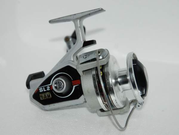

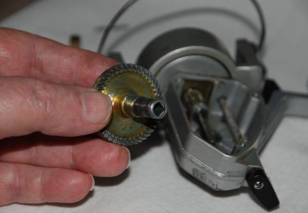

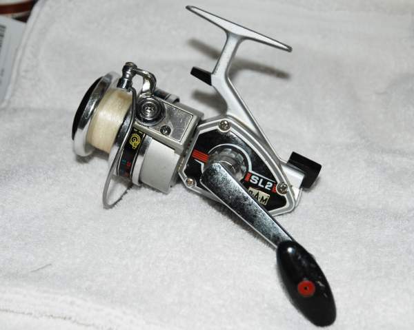

Here's my first non-German DAM Quick.  Not sure when these reels were manufactured, probably 1980s.  It's nowhere near the quality of the Finessa series, but I don't have enough $$ invested in it to worry, was only curious.

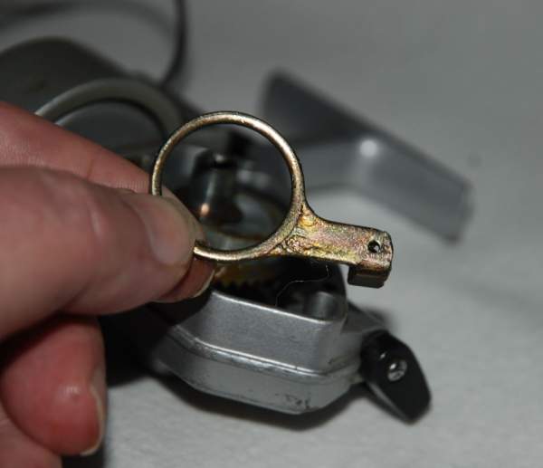

Not having a schematic, I had no idea what to look for inside.  But I wasn't surprised, it's an loop type oscillator with very simple engineering.

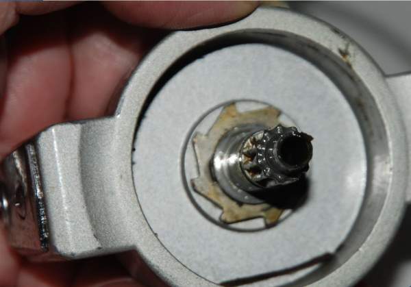

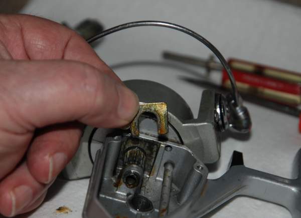

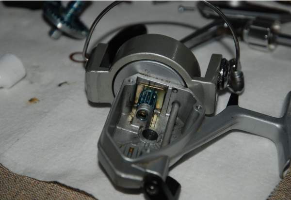

Another common feature on these type of reels is the pinion built into the rotor with a c-type retainer.

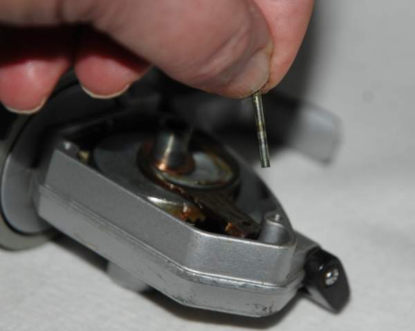

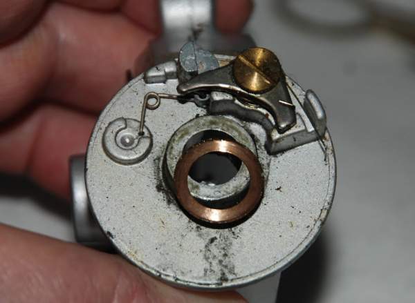

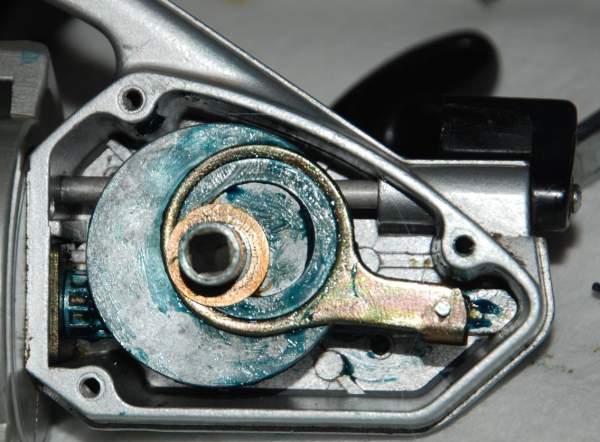

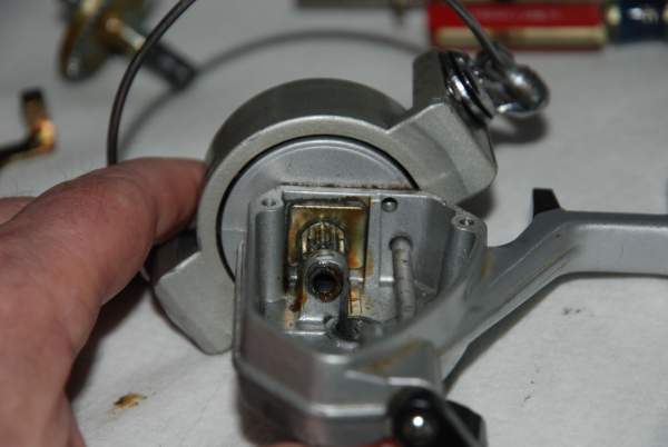

A look at the anti-reverse assembly which is one of the reels better features.

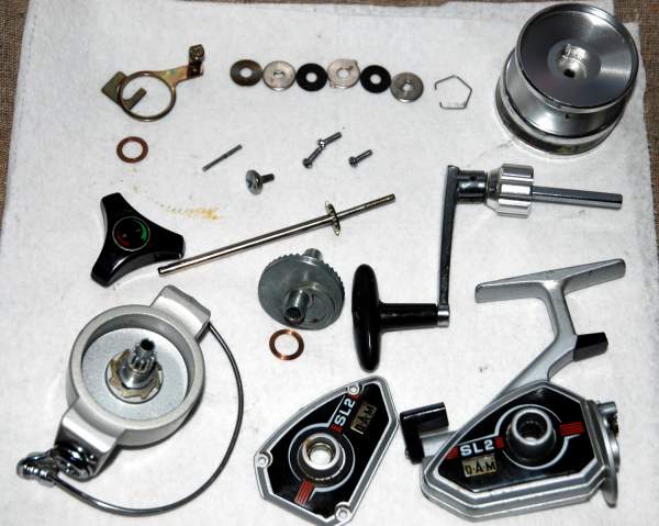

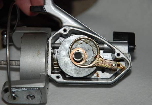

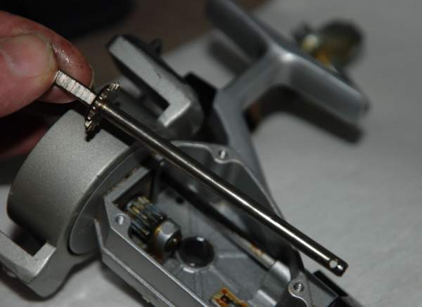

Yes, they're very simple reels and remind me of the lower end Daiwas from the same time frame.  Olympics and Ryobi were also similar. I don't know if this drag washer sequence is correct, but it's the same order which I took it apart.

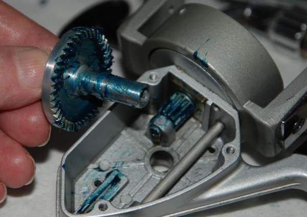

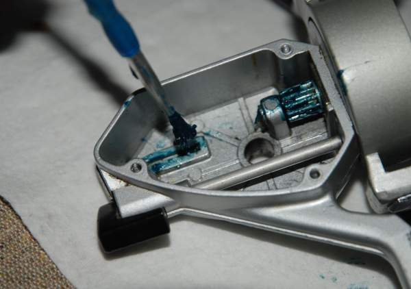

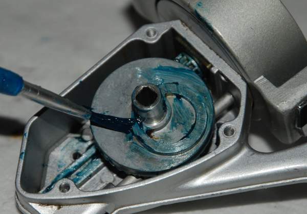

I'll touch on a bit of the reassembly, didn't want to spend much time on this reel.
These reels weigh 15.6 oz, have line capacity of 230 yds of 10 lb mono, 185/12 and 140/15.  It's my guess these reels cost not much more than 12 or 15  bucks off the shelf when they were new unless someone was only paying for the DAM name. I don't really have any complaints, they'll probably do anything a comparable Daiwa or Ryobi from that time frame would do.

   That pinion/rotor held in by the c-retainer is the line in the sand for me...I don't really know why...but that just makes me grit my teeth. I suppose its because of the sloppy fitment. That design always leaves the rotor teetering around like the nut is loose or something. Interesting note you made about the AR though Chester. It seems odd having that set up amidst all the other "short cuts". Thanks for the walk through. 8)
Actually this one isn't sloppy at all.  Maybe someone added this shim to fix that problem.  This reel reminds me of the Daiwa 1500C which has the same c-retainer but it actually feels better than the Daiwa.
