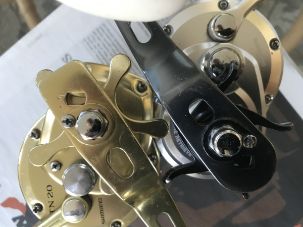

They are what a Trinidad should be, I have a 4000 series Ocea Jigger I can show you sometime.
Sure appreciate it if you could share it to me Keta.
