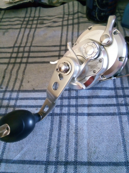

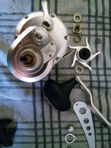

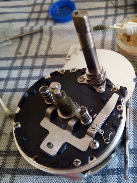

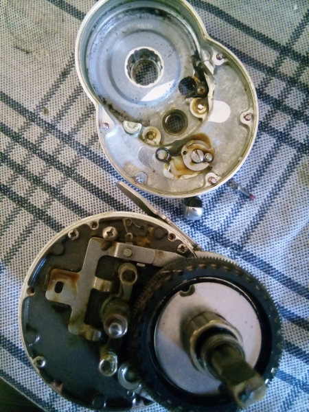

Well, what has to be done must be done so I decided to clean both of my OJs. Pictures show the 2001 model which is a lefty. Note that the handle nut loosens in a clockwise direction. Rest of the photos show a newly opened reel.
edgarz
I forgot to mention the last picture is a newly cleaned 2000 model.Some points to ponder;
1. You have to be careful with the screws that they don't get rounded. I wonder if Shimano has a set of screwdrivers for their reels.
2. Take a photo of the springs in their position to eliminate guessing later on.
3. The bearings are sealed permanently. I wish someone could market rubber seals as replacements.
boon
The screws are probably JIS not Phillips. Dedicated screwdriver set is the answer.
edgarz
boon if you look at the pictures you will see that they are not.
