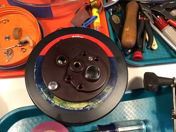

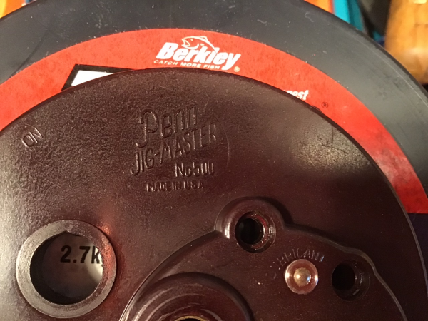

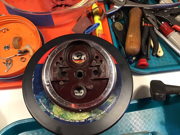

Good morning guys. Hope everyone's doing OK. Just want to post this so others can learn from my mistake. Been servicing reels for quite awhile, mine and friends, with no problems. All types of Penn Conventionals. So I was doing an older Jigmaster 500 w/dark Maroon plates for the first time. Done many newer 500S Jigmaters red plates with no problem. Thought they were pretty much all the same. WRONG !!! I should have checked here first before removing inner and outer side plate rings, I didn't. I was so used to taking all four off. If they were stuck on I would pry off easily with a sheet rock knife. Well I tried prying off the inner ring on the handle side plate and to my surprise It's Not Supposed To Come OFF !!!! Needless to say the pins on the ring pulled out chunks of the plate. Attached are the pictures of my stupidity. Don't be like me. Ask First then Do. Thanks guys.                                             Richy

Is there any sign of the pins from the outside, before trying to pry off the plate?
I ask because I have struggled with removing inner rings, but have not yet muscled one enough make that mistake.

That must have been one heck of a pry!  :o

Hey Decker there is. On the outside edge of the ring you can see small pin heads sticking up. I saw them but ignored them and this is what happens.

It sure was broke the blade on the sheet rock knife !!  :o
