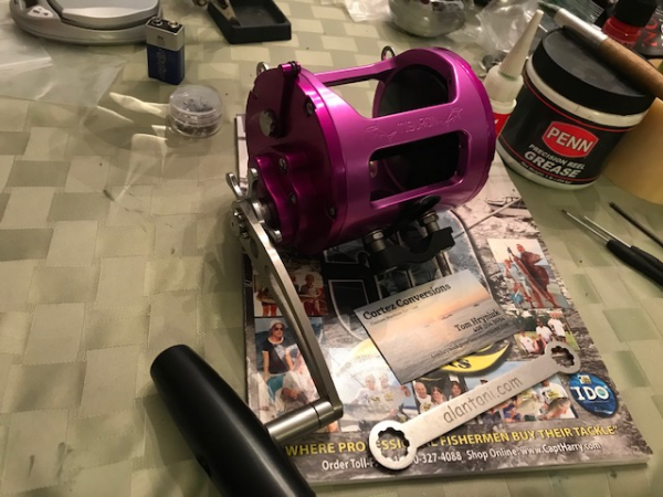

Tile

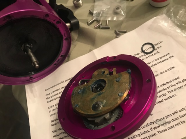

Here she is, the 113HLW 4/0 Senator. After a quick service I discovered that the reel already has the HT-100 drag washers, not sure if they were present from factory or were added later on as there was a lot of Cal's grease on the geartrain.

Tile
The graphite frame on this particular rel has brass inserts, so no self tappers here :) . The reel in question is an US-made one. The next step is to clean all the patina on the brass parts and to fully relube it. The main gear and pinion were almost caked in Cal's grease.

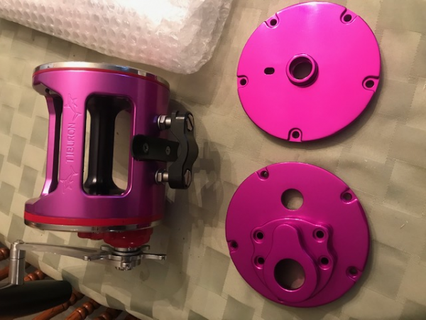

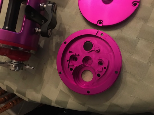

Tile
After having a look on the images of the sides both from the older and newer generation Senators, there is a good chance that the Tiburon frames may be a direct fitment, albeit the number of screws per side may be less ( or more if someone decides to use older style rings as guides to make new extra holes fpr more affixing screws)
