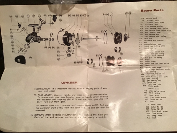

Does anyone happen to have a schematic for a Bretton 400?  Thanks, Joe.
They're tough to find unless you have a boxed reel &/or a manual.
They're really not that complicated, pretty much standard worm gear driven. The anti-reverse is pretty cheaply made, though, with the plastic dog and nylon ratchet gear. Be careful when remove the pinion worm gear, the bearing is 34 loose balls sandwiched between two races. Do it in a container or you may be chasing balls around the room.  ::)
Here is one --

basenjib123
Thanks Fred much appreciated... too late on the ball bearings  ;D ... amazing I was able to recover all 34 BB!!  Well built reel but what a stupid design for the bearings.
