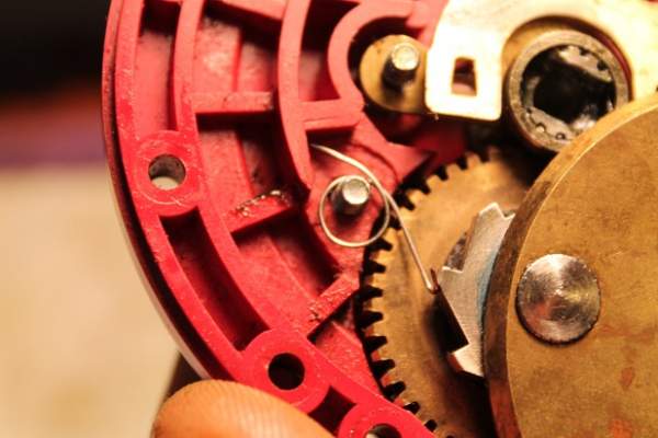

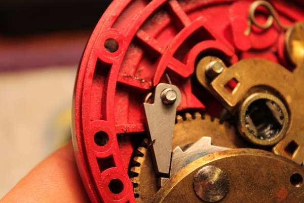

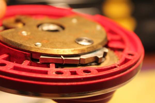

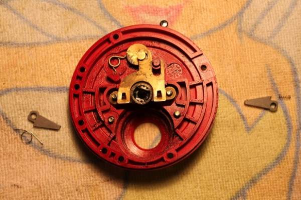

G'day lads,

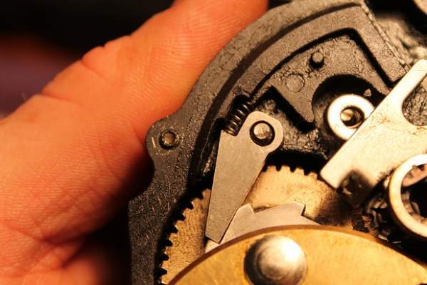

I was asked recently by AT member Peter (p-deverett) to double-dog a couple of 113Hs and, given they're both variations on the theme, thought a few pics might be of use to others...
The first is an injection-molded 113H.

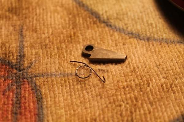

There was no 'meat' within which to fit the second dog and spring, so I cut away the unnecessary plastic, then took Will's suggestion and twisted up a S/S torsion spring instead.
It's important to create a little clearance via a small, circular hollow beneath the dog, like so:
The spring wedges into the corner thus:
As you can see, there's plenty of clearance between the spring, the dog and the main gear.
Also, despite the camera angle, there's clearance between the spring hook and the bridge plate.

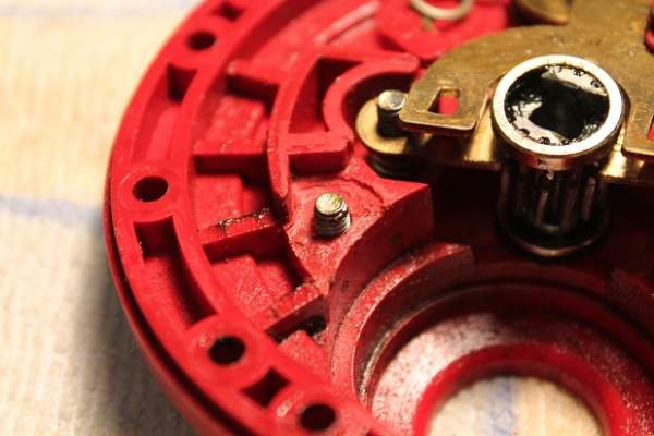

The second was a Pro Gear GR3500.
Hope that's of some interest/assistance.
All the best, Justin
