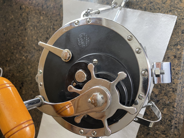

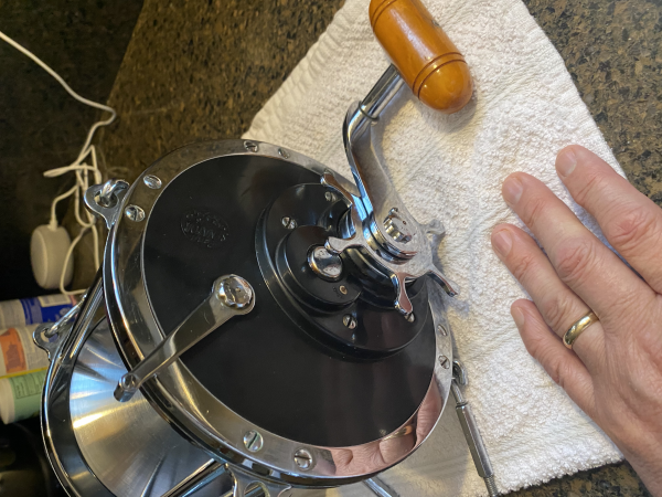

There is an Ultimate Upgrades 5-stack kit for the 970/980.   From what others have said about those reels, they are overbuilt in terms of the gears and spool shaft, equal to a 113H.  Sal (Alto Mare) has a lot to say about them.  There are many handle and star upgrades.   I haven't upgrade mine yet but it is on my list.
vilters
i added the 5 stack drag kit to mine. i also added a stainless gear sleeve - the one for a 113h is the same and works. i found a steel dog i had gotten from keta that fit once i had modified it - og dog is not the same as 113h. i also installed a 113h drag star - it is larger diameter overall than the og, or you could use any other star that fits a 113h. cortez conversion eccentric lever was added along with a penn handle w/ larger grip, again any handle that fits 113h is an option. great little reels.
