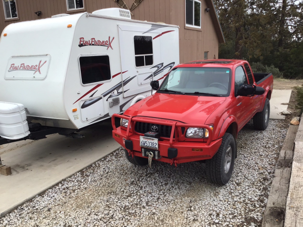

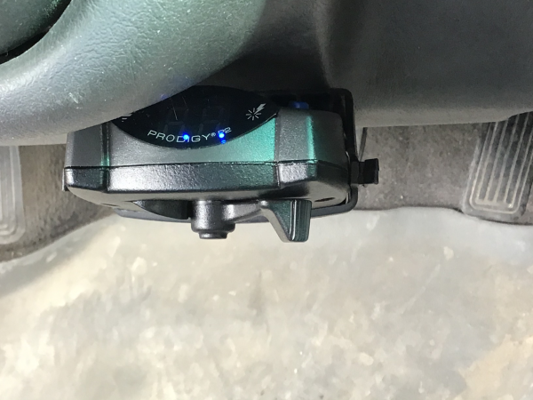

Just returned last week from a trip out to the Desert for 8 days — trailer brakes were not energizing properly — showing an "open ground" code.
When we returned, I decided to check it out further.  Knowing that most issues are generally also the most common cause — I traced all of the wires that were installed by U-Haul when they installed the brake controller — all good, until I found where they had attached the control unit ground wire behind the drivers kick panel — with a rivet which had of course...loosened!!  Cut the wire, attached a crimp ring, along with a self-tapper hex screw.  Works perfectly.
Yesterday, I decided to install an in-cab switch assembly for my Warn M8000 winch.  This goes where the clock was on the 4X4 Tacoma — and consists of a two button momentary IN-OUT assembly — along with a master shielded safety toggle which activates the power to the switches, as well as an indicator LED light.
Pulled apart the dashboard, routed all wires up to the winch, wired everything up — no power to the winch.  Knowing it was likely a non-grounding issue — but not knowing which of the (4) solenoids I needed to attach grounds to — I was confused.  Finally remembered my electronics training — and the importance of solid grounds — I figured out that my winch had (5) wires coming into the control box from the remote control — instead of the more typical (3).  The (2) extra wires were a ground loop that in an emergency would disconnect power to the winch when the plug was pulled out.  I ran a direct ground from the common ground lug assembly in the middle of the solenoid array — directly to the winch motor.  Then ran another wire from the same lug and attached it to the solenoid base.
Now I can use the winch from inside the cab while operating the vehicle easier than running the remote control through the drivers window.  And the remote control wired switch still works as before.
A faulty or corroded ground connection (or multiple connections to ground) are usually the culprit with any of our boats, trailers, or equipment that requires 12 Volt DC to operate.
