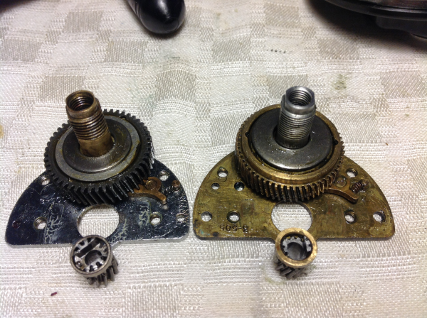

I thought that the HS reels were structurally stronger than than the regular Jigmasters with one possible exception: the 5:1 gears in the HS Jigmasters, had a wider diameter main gear with smaller teeth. I'd heard somewhere( probably here) that they might shred easier than the old 500/501 gears. I asked if anyone had ever heard of this happening---no answers, till now!
Still ya never know. The 4:1's mighta done the same thing under that kinda stress.
If you wanna see a side by side picture of the 2 different gears check out the thread in the section "Penn 99/Jigmaster/Surfmaster/etc." from the main page. There is quite a visiual diffrence in teeth size between the two. Someone like Jurelometer could probably make diffrence measurements and calculate strength diffrences under a given load for gears made outta the same material. Ha!. Great and interesting stuff J.!
Here's the picture; std. 500 series gears-left, HS series gears-right.
