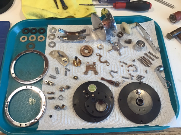

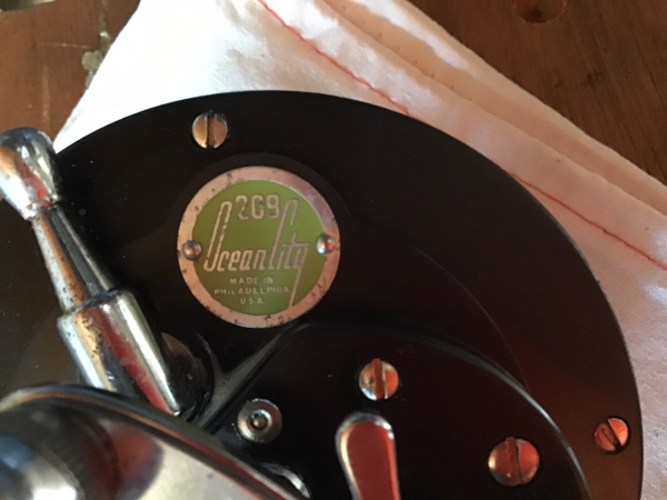

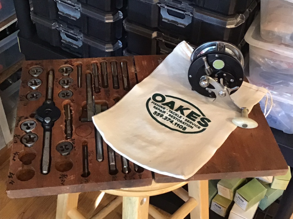

Got the 80 year old OC 209 completed for Dominick --
Removed the Verdigris green corrosion, crud, neutralized and stopped the rust, polished all of the insides -- and the exterior as much as possible.
Needed to do a little surgery for a couple of broken off screws in the posts.  Typically, I would just replace the posts -- but these narrow guys are beyond tough to source.  So -- drill, extract, re-tapped a couple.
Found some new 80 YO OC drags in an old bin.

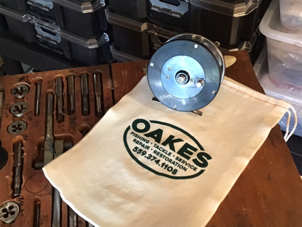

This is a very narrow reel at 1 1/8" wide -- but a tall spool.
New drags, new lubricants, 1 minute and 40 seconds of free-spool with brass bushings.
This reel is impressive.  The engineering and components of this old OC -- are actually stronger than a Penn -- not the 349 -- but the 49.
Let's hear it for Fred.  That is professional work.  Fred has the hands of a surgeon.  A minute and 40 seconds of free spool.  You can't beat it.  Thanks Fred.  Dominick
