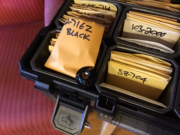

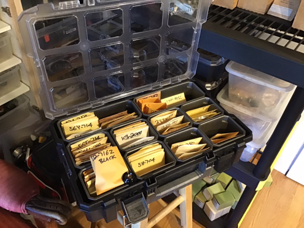

I should have plenty of both sizes of washers.  Have plenty of new old stock Penn spinning parts.
Mystic would be the best bet immediately.
We may not be back to our home for 3-4 more weeks -- and then reels won't be on the top of the agenda for some time after that.
But I would be glad to help as soon as it is possible.
