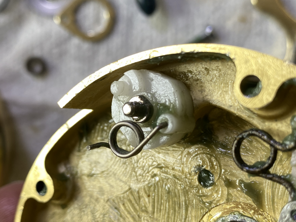

Shimano 4000GT and 2000GT mooching reels....20+ years and countless hours salmon fishing and far too many salmon killed to even estimate. They just keep on going and never serviced since new. I'll check them in 2040 to see if they need servicing yet #wink #wink
Very simple internals. Clicker sways both ways and clicks when reeling or line peeling. It isn't super loud like most reels, but still very audible. It does have anti reverse dog and also has freespool lever. I'm guessing maybe 10# of drag, but hold onto the knob and drag is according to how much you hold onto the knob. I like hold on extra long until rod is loaded up, then let go as the reel unloads and knobs spin like spokes on a bicycle. This is where the term "knucklebuster" originates from. It only takes once to learn to get fingers outta the way, but still close enough to grab fast and crank as a line peeler can sometimes turn and swim strait back atcha

The only thing I ever see go wrong with those other than totally worn drag washers is warped or cracked spools. Take the mono off in the winter, or but some dacron on for cushion and you will be good to go for a long time. I don't know why its mostly here in BC that we use "mooching" reels .......................... even Ron can get the hang of it ! ;D

The old ones had the plastic type "Dartamin" (spp). The washer under the spool is canvas. I replace with greased CF drag washers and they will last for ever. Remember we play the fish with very little drag as we "palm" the reel for drag, more fun and you can have as little or much drag as you want instantly.
